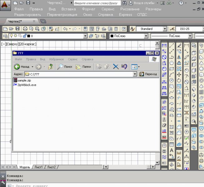

samifox Posted July 13, 2017 Posted July 13, 2017 hi i want to establish a program that will 1.open a zip archive to a temporary folder 2.for each dwg #perform wblock on file.dwg #save to the same location file_wb.dwg #delete file.dwg #rename to file.dwg 3.add it all to archive archive_wb.zip i would start working on that, want to make sure if something like this already exist? or some part of it Thanks S Quote

maratovich Posted July 15, 2017 Posted July 15, 2017 maratovich I disagree you can use startapp to run the zip bit at start, the wblock 2-3, lines save 2-3 lines, close 1 line delete use vla-delete 1 line, rename vla-rename, use startapp again to make a new zip. BIGAL You have intrigued me. This is a matter of principle. 8 hours of work was spent. This picture .gif, the big size here does not show, save on the computer. ZipWblock.zip Quote

samifox Posted July 16, 2017 Author Posted July 16, 2017 BIGAL You have intrigued me.This is a matter of principle. 8 hours of work was spent. This picture .gif, the big size here does not show, save on the computer. WEll done:) friend before runing this fantastic program please remove student stamp Quote
