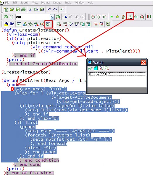

Lee Mac Posted January 14, 2009 Share Posted January 14, 2009 Nice one ASMI - class as always. but why do you have to use (car Args)? Quote Link to comment Share on other sites More sharing options...

ASMI Posted January 14, 2009 Share Posted January 14, 2009 but why do you have to use (car Args)? Can you stand break-point and look Wach Window for Args value? It will answer for your question. Quote Link to comment Share on other sites More sharing options...

Lee Mac Posted January 14, 2009 Share Posted January 14, 2009 Can you stand break-point and look Wach Window for Args value? It will answer for your question. Sorry, you lost me there? Quote Link to comment Share on other sites More sharing options...
ASMI Posted January 14, 2009 Share Posted January 14, 2009 Sorry, you lost me there? This is a secret map to find treasures: Quote Link to comment Share on other sites More sharing options...
Lee Mac Posted January 14, 2009 Share Posted January 14, 2009 This is a secret map to find treasures: Haha ASMI you are a legend Quote Link to comment Share on other sites More sharing options...
