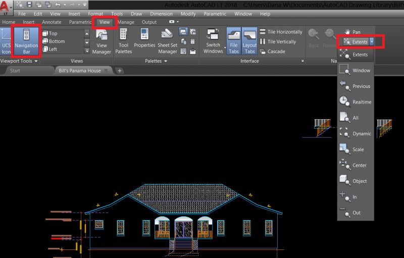

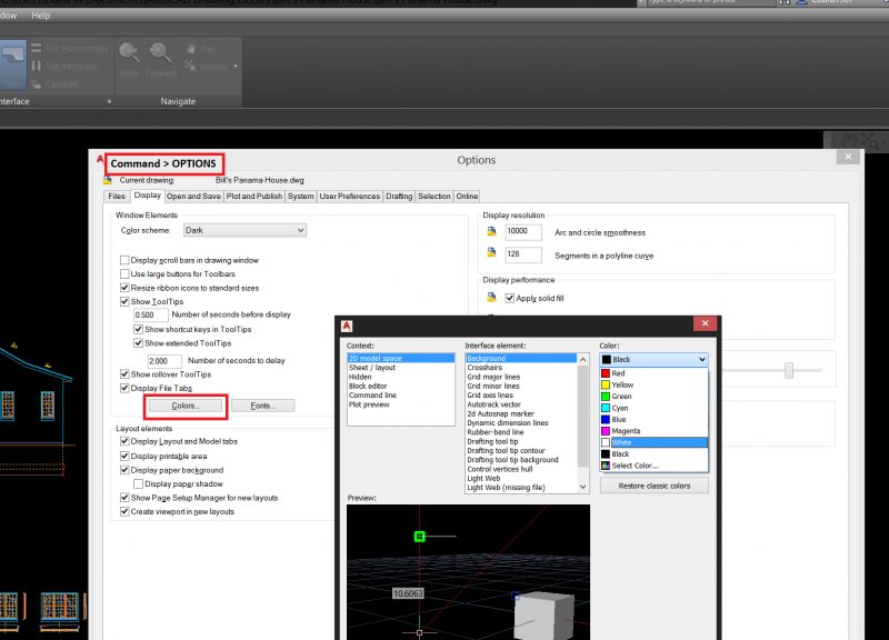

What is the procedure to change the background color to white in AutoCAD 2018? Also where do I find the zoom tools?

Re: Background. Same as it has always been. Via Options > Display > Colors.
Re: Zoom "tools". Are you referring to the Zoom toolbar?
No offence Gotchy but "white" ? maybe go for a real light grey a rgb colour. Just find white to be a hard colour to view continuously Also like Remark suggestion you need to possibly change the Model space and the Layout space. Or are you just trying to make it look like the printed page on white paper just do a Plot preview instead. Out of the box the layout is set to white.
for zooming, set NAVBARDISPLAY to 1, or Z>A, Z>E, Z>O. etc, etc.... Or this.
