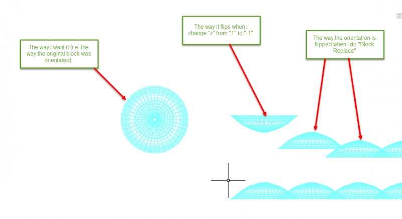

Please see attached drawing. There are two blocks. There is 1 instance of "Spk_Umbrella_1" (located at 0,0,0) and hundreds of "Fitting11_7101". I'm looking to replace all the "Fitting11_11" with "Spk_Umbrella_1", however when I do the "Block Replace" command (from Express Tools) when it changes the block it 'flips it' to the wrong orientation.
The block "Spk Umbrella_1" is combination of 3D Faces.

the easiest solution may be to select all the blocks that have been 'flipped' and then in 'properties', 'geometry', change one of the scales
E.G.
from
x = 1
y = 1
z = 1
to
x=1
y = -1
z = 1
if y & z are greyed out you will have to open the block in block editor and select 'no' for 'scale uniformly'.

However, I'm still stuck. When I change the z from 1 to -1 it flips it 180 degrees, however I only want it flipped 90. Please see attached screen shot. Changing x & y didn't help.

that's the easy fix out the window then.
another solution might be to remake the errant block but with x y &/or z rotated to suit. it might take a bit of trial and error. call the modified block a new name or if you want to keep the name, remove all instances of that block & do a purge before you insert the modified block .
sorry, but i am just on my laptop atm & can't try this for you right now.
the above is just a suggestion to try. someone may well come along with a tested solution.
That works as a 'work around' so perfect for me!
