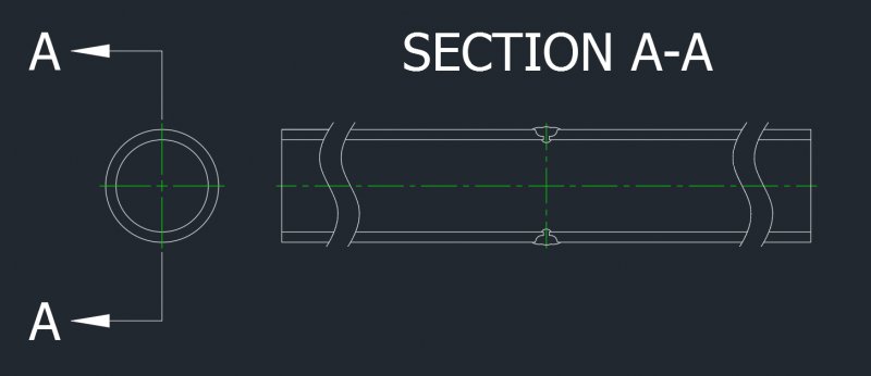

neondeon298 Posted October 17, 2017 Posted October 17, 2017 Trying to show that a pipe is longer than how I have drawn it (trying to save paper space). Is the break line I've used sufficient or does it immediately tell the reader that I'm a rookie? Mot that I truly care what they think... its my drawing. But yea, just your thoughts on drafting standards. Quote
rkmcswain Posted October 17, 2017 Posted October 17, 2017 Looks ok to me. I think this example shows what might be a more conventional type of break line layout (where the A-A is on the horiz pipe?) Quote
neondeon298 Posted October 17, 2017 Author Posted October 17, 2017 http://draftingmanuals.tpub.com/14276/img/14276_145_1.jpg Yea see I generally use your example for non-pipe, but the linked jpg shows pipe having some wavy action. But its a section view as well so neither of those in the link would work. But I like your answer so I'm gonna stick to it lol... Thanks. Quote
BIGAL Posted October 18, 2017 Posted October 18, 2017 (edited) Here is round tubular, maybe a 1980's version. ; DRAWS ELLIPSEOID ENDS ON A PIPE (SETQ PT1 (GETPOINT "\n PICK PT1")) (SETQ PT2 (GETPOINT "\n PICK PT2")) (SETQ DIST (DISTANCE PT1 PT2)) (SETQ ANG (ANGLE PT1 PT2)) (SETQ MIDPT (POLAR PT1 ang (/ DIST 2.0))) (SETQ BULGE (GETREAL "\n ENTER BULGE FACTOR <40> ")) (if (= BULGE nil)(setq BULGE 0.4)(setq bulge (/ bulge 100))) (SETQ DIST (/ DIST 4.0)) (SETQ PT3 (POLAR PT1 ANG DIST)) (SETQ ANG (+ ANG 1.5714)) (SETQ DIST (* DIST BULGE)) (SETQ PT3 (POLAR PT3 ANG DIST)) (COMMAND "ARC" PT1 PT3 MIDPT) (COMMAND "COPY" "L" "" PT1 MIDPT) (COMMAND "MIRROR" "L" "" PT1 PT2 "N") (setq bulge nil pt1 nil pt2 nil) (PRINC) Edited October 19, 2017 by BIGAL Quote
SLW210 Posted October 18, 2017 Posted October 18, 2017 Ore use the LISP found HERE by Kent Cooper. I generally use the one for Round Tubular in your example in the link for pipe. Quote
