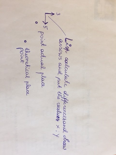

Theoretical and actual Point X and Y differeces!
Margusrebase
I need autolisp that can calculate differences between theoretical point and actualpoint and draw arrows and put x;y values.
NB! Look attachment!

Margusrebase
Actually these are two point and i need differences between points! Autolisp draw arrows and value x;y!

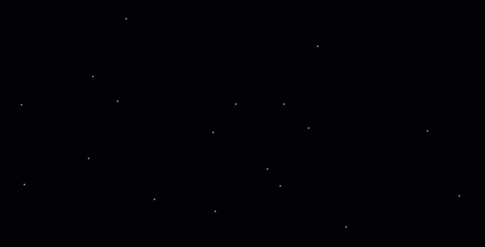

BIGAL
Way to go for lots of points is make a selection set of real points make a selection set of theorectical, you can then check how close the points are using a tolerance, the choice is your then x1,y1 -> x2,y2 = dist to file, on screen or dim like Aftertouch. Also did not find's !

Margusrebase
This is almost that i need but ... can you edit code like this: autolisp draw arrows and differences (mm) end of arrow!
See attachment above!

ronjonp
Another:
