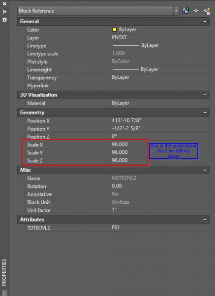

i work on projects that sometimes i have to have 1/4" and 1/8" scale on the same sheet. and i know that you can go into the modeling space and select the objects that you want to change from 1/4" to 1/8" or the other way around, go to properties and scale your "X, Y, Z" from either 48 to 96 or 96 to 48.

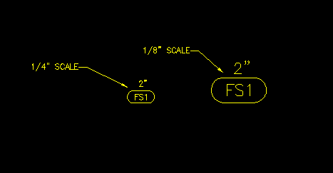

we use the plot space and have view ports yes. but if you have text height at 8" and set your viewport to 1/4" scale then your text is going to be massive,

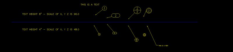

in the model space if you set one set of text height to 8" and another to 4" then go to model space and create two viewports you have one for 1/8" and one for 1/4".

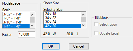

here are a few screen shots for what i am talking about. i hope that this helps explain it a little better. either that or i am not understanding what your talking about. sorry i am still new to the cad thing. well using it daily that is.

this is the way that the company that i work for wants to do things. and i am not trying to do something different and cause issues. i do see what you are saying but they have "drawing standards" that i have to follow for each scale. so just setting the viewports are either 1/4" or 1/8" doesnt work just right. i see what you are talking about (i tried it) but being that i work in corp america i have to do as told. just trying to find something that within the model space i can select one of the objects (seen in two new photos) type command and hit spacebar and bingo, instead of going to the prop. and changing from 96 to 48 or other way around. sorry if this came across rude, i am not trying to at all i am just frustrated that i am not explaining it the way i was thinking it.

with the company having standards this isnt something that they have had to deal with. normally we put 1/8" plans on one sheet and 1/4"on another. however i have a lot of small jobs and i just like to keep things on as little sheets as possible.
so i just want to be able to grab a few things and type a command in and have it rescale the text or the block (for tags) from 1/8" (96.0 inch) to 1/4" (48.0 inch) i know that if it is something that i have to do with one or two no sweat to go into the properties and change it that way.
but when we have the drawing set up as 1/8" scale and you want to add a 1/4" scale to show additional detail on the same sheet, just changing the viewport wont shrink up the text and tags to be able to show this area in a little more detail.
