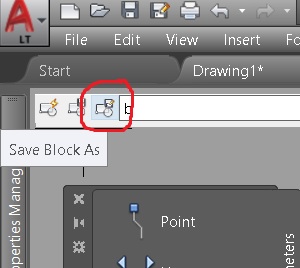

So long as the blocks have different names there shouldn't be a problem. If you open the block editor and make your changes/additions then save the block as a new name

Once again, Thank you. That will save me a ton of time. I already have my visibility states in place that's why I didn't want to have to go thru all that.
