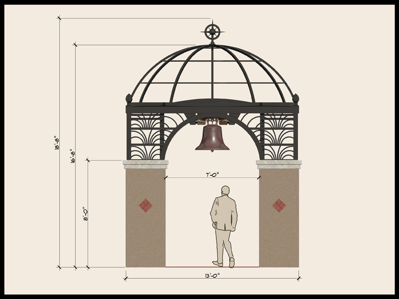

Cad64 Posted December 4, 2017 Posted December 4, 2017 If he's talking about dimensions then not only will he need to use the TrueTypeFont font with a thickness, but he will also have to do something about the extension lines, arrowheads, etc. I'm with f700es. I would add the text and dimensions in an image editor after rendering. A simple way to do this would be to set up a viewport with your model, text, dimensions etc. Then do a render to get your image. After that, turn off your model in the viewport and print a pdf of your text and dimensions. Then simply composite the two together in your image editor. I have done this sort of thing before and it's very quick and easy. Here's one I did a while back using the procedure I mentioned above. Quote
f700es Posted December 4, 2017 Posted December 4, 2017 Why slow down the render with things you can add in afterwords? Quote
Cad64 Posted December 4, 2017 Posted December 4, 2017 Why slow down the render with things you can add in afterwords? Like I always say, work smart, not hard. Quote
f700es Posted December 4, 2017 Posted December 4, 2017 Yep, I'd add those in with Illustrator, Corel Draw or Inkscape. Quote
