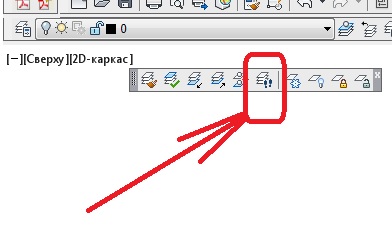

maratovich Posted December 4, 2017 Share Posted December 4, 2017 arunkumarunicorn Use this : Quote Link to comment Share on other sites More sharing options...

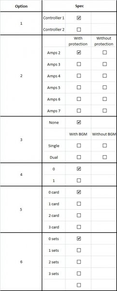

arunkumarunicorn Posted December 5, 2017 Author Share Posted December 5, 2017 Hi, I select the layers ( options & spec in excel ). Each spec is a layer in drawing. After selecting the layer from the excel, a process should initiate from excel to open the autocad drawing. The drawing should open with the checked layers from the excel as visible. Quote Link to comment Share on other sites More sharing options...
