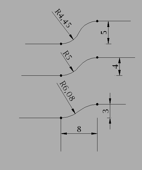

L-P Posted December 22, 2017 Posted December 22, 2017 If drawing two radius 5 curves, so that the horizontal is 8 units as shown, where would you place the centres of the 5 radius circles? I think possibly also a circle may have to be offset to achieve this, I'm not sure. I've tried various scenarios of radius 5 circles, but can't get it to quite match. Thanks for any help! Quote

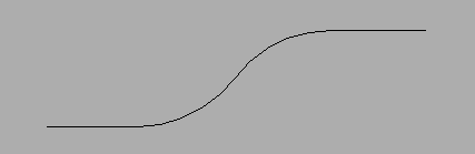

L-P Posted December 23, 2017 Author Posted December 23, 2017 The way I went about it was as follows. I drew a radius 10 circle centred on the right side of the measurement 8. Then I drew a radius 5 circle centred on the left side of the measurement 8. Then where this last circle and the radius 10 circle intersect I drew a new circle of radius 5 (highlighted in image below. Then I trimmed away excess. Quote
L-P Posted December 23, 2017 Author Posted December 23, 2017 Also, I started off with a radius 5 circle centred on the right of the measurement 8. Should have mentioned that. Quote
eldon Posted December 23, 2017 Posted December 23, 2017 Thank you for sharing your solution. It is pretty much how I drew it up, but, as ever, there are many ways that lead to the same solution, although some use fewer key strokes than others! Quote
tombu Posted December 25, 2017 Posted December 25, 2017 Too much information. For the arcs to be tangent to lines and each other you cannot hold both the 5' radius and the horizontal distance of 8'. The image above holds only the 5' radius. Quote
eldon Posted December 25, 2017 Posted December 25, 2017 I would have thought just enough information. For a horizontal distance of 8, there are arcs of many radii to join, but each arc has its vertical distance. Quote
steven-g Posted December 25, 2017 Posted December 25, 2017 The question implies that the distance of 8 units is the distance between the centres of the two arcs measured horizontally, it also implies that the where the arcs meet they are tangent. With only that information there are 2 answers.Both of which use a vertical difference of 6 units between the centres. Though obviously, only one meets the visual image given. Quote

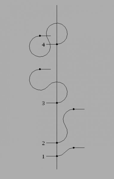

eldon Posted December 26, 2017 Posted December 26, 2017 The question implies that the distance of 8 units is the distance between the centres of the two arcs measured horizontally, it also implies that the where the arcs meet they are tangent.......... There are in fact a couple more answers (what is a negative sign between friends), but scenario 1 seems to meets the OP's requirement. Quote
L-P Posted January 16, 2018 Author Posted January 16, 2018 (edited) I was having a look again at the replies by eldon and steven-g above. From my attempt, shown in the 2nd image I posted above, the vertical height of the curve I drew would be 5 since the circles were radius 5. Are you both saying that the vertical height should be 4? How do I position the radius 5 circles to achieve the height of 4? Or do I use one of the tan functions within AutoCad to achieve this? Edited January 16, 2018 by L-P Quote

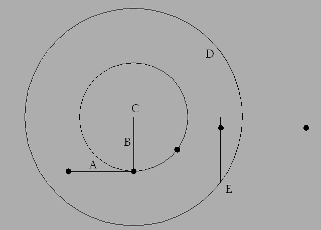

eldon Posted January 16, 2018 Posted January 16, 2018 The initial requirement was for a reverse curve using curves of radius 5, with a horizontal separation of the tangent points being 8. There is only one solution for this and the vertical separation of the tangent points just happens to be 4. To construct this, I first of all drew the line A. Offset this upwards by 5, and draw line B to join the end at C. Draw a circle radius 5 centred on C, and offset this outwards by 5 to give circle D. Offset the line B by 8 to the right, and extend it downwards to meet circle D at E. This is the centre of your second 5 radius circle. Measure up 5 from E to give the second horizontal line. This happens to be 4 higher than the first horizontal line. Draw in the circles and horizontal line, trim and there you are. However, I noticed that the difference in coordinates were nice small integers, and using the fact that AutoCAD will draw an arc tangential to a line or arc drawn immediately before, I drew the lines and reverse curve directly with this as the command line:- LINE Specify first point: Specify next point or [undo]: Specify next point or [undo]: Command: a ARC Specify start point of arc or : Specify end point of arc: @4,2 Command: a ARC Specify start point of arc or : Specify end point of arc: @4,2 Command: l LINE Specify first point: Length of line: Specify next point or [undo]: Quote
L-P Posted January 16, 2018 Author Posted January 16, 2018 Thanks very much for that. I tried that for myself using your first method. Interesting that it does give a different solution to my original attempt. Quote
