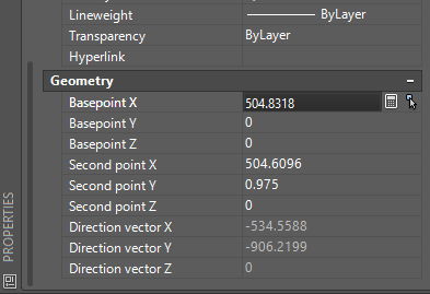

I am using AutoCAD 2015. I am dummie in LISP. I need to creat a lot of rays. And I decided to optimize this process. BUT!
When I use simple procedure right in command string:
Command: (command "RAY" "500,100" "400,500" "")
RAY Specify start point: 500,100
Specify through point: 400,500
Command: nil
AutoCAD drew ray with different coordinates:
I don't understand: WTF?!

I don't know lisp, but does your drawing contain other geometry close to those points, I know from working with scripts in LT that Autocad will still 'snap' to objects depending on zoom levels and you need to make allowances for that using the "non" command modifier before each coordinate, try your code in an empty drawing to see how that works.

The command:
works for me. Make sure you do not have OSNAP on and that it's screwing things up! You can do it in vlisp with:
(setvar "osmode" 0)

The command:
(setvar "osmode" 0)
Yes, It works in a new file. I will add setvar in the command. After that I will report my result. Thx a lot!
