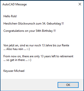

HappyBirthday.lsp ==>Fun vs. prank
Hi together,
I would like to play a trick on my draftsman colleagues and I needed some help.
...feel free to improve my poor coding...

here's one way to get the suffix
(setq suffix (chr (last (vl-string->list age))))
(cond ((eq suffix "1") (setq suffix "st"))
     ((eq suffix "2") (setq suffix "nd"))
     ((eq suffix "3") (setq suffix "rd"))
     ( T (setq suffix "th"))
"13rd" ;)
Here's another possible way:
(defun ordinal ( n )
   (cond ((< 10 (rem n 100) 14) "th") ((nth (rem n 10) '(nil "st" "nd" "rd"))) ("th"))
_$ (ordinal 13)
"th"
_$ (ordinal 21)
"st"
_$ (ordinal 123)
"rd"
How about something like this?
(   (lambda ( lst / age itm ord ret )
       (defun ord ( n ) (cond ((< 10 (rem n 100) 14) "th") ((nth (rem n 10) '(nil "st" "nd" "rd"))) ("th")))
       (cond
           (   (null (setq itm (assoc (strcase (getvar 'loginname)) lst)))
               (princ "\nSorry, user not listed!")
           (   (zerop (rem (setq age (- (fix (getvar 'cdate)) (caddr itm))) 10000))
               (setq age (/ age 10000)
                     ret (- (cadddr itm) age)
               (alert
                   (strcat
                       "Hello " (cadr itm) "!"
                       "\n\nHerzlichen Glückwunsch zum " (itoa age) ". Geburtstag !!!"
                       "\n\nCongratulations on your " (itoa age) (ord age) " Birthday !!!"
                       "\n\n\n\nVon jetzt an, sind es nur noch " (itoa ret) " Jahre bis zur Rente \n... Also hau rein ... :-)"
                       "\n\nFrom now on, there are only " (itoa ret) " years left to retirement \n... so get in there ... :-)"
                       "\n\n\nKeyuser Michael"
       ("MH019" "Michael" 19991003 67)
       ("MH019" "Michael" 20180109 67)
       ("MH019" "Michael" 20180110 67)
Copy the above into your acaddoc.lsp ;)

Hi together,
Thanks to everyone, I appreciate that very much ! :)
@ Lee Mac
I didn't get your code to run. I put it on my acaddoc.lsp but nothing happens.
What I'm doing wrong?
... and I have problems to understand what's going on. Could you please add some comments/explanations for me?

@ Lee Mac
It will only run when there is a birthday to be celebrated!
Try adding a new user to the list whose birthday is today ;)
Thank you Lee Mac !!!
now I got it. ...but didn't understand the code :cry:
is there a way to not pank my draftsman the whole day?
... 3 or 4 times would be enough ...
Something like this perhaps:
(   (lambda ( lst / age itm ord ret tmp )

Great !!! :)
... but I would like to prank a little bit... o:)
is it possible to add a counter which I could set to show up 3-4 times?

Thanks! :)
I hope it works as supposed - didn't found any problems in my initial testing.
Great !!! :)
The following will 'prank' the user between 1 and 5 times if they 'roll a 3' when opening a drawing ;) :

([color=BLUE]princ[/color])
Edited by Lee Mac
