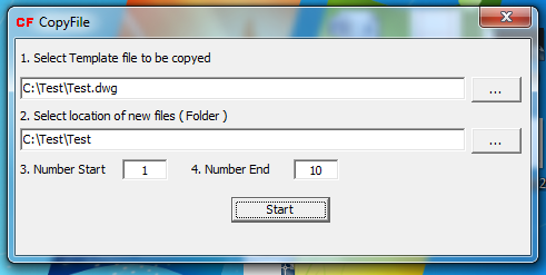

maratovich
I am at rookie level at VBA in excel and totally new to VBA in CAD.
You need to study the connection from Excel to AutoCAD.
If there is no time - you can use it.
CopyFile.zip
  • Thanks 1

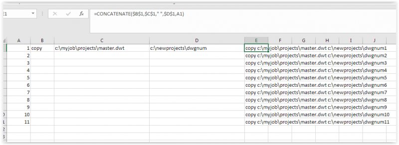

BIGAL
Nice maratovich
simple excel copy the E column to notepad save as a batch file .BAT and use CMD from windows all done.

Mushtaq86
Dear Maratovich,
Thanks for the attachment. It is helpful to some extent.
Share this post

Mushtaq86
@ maratovich... thanks for the response and attachment.
@Bigal: thanks for the "batch" file process explanation.
Both options are helpful to an extent.

Mushtaq86
Dear Bigal,
Thanks for the explanation of batch process. Though renaming isn't accepting "spaces", it is also helpful to some extent.
Thanks again.
