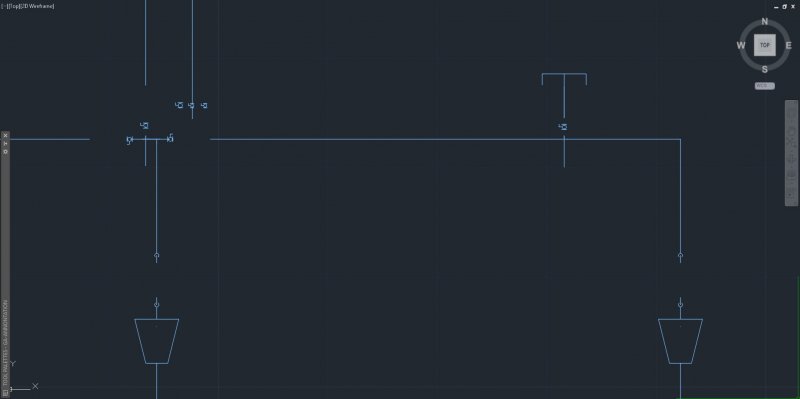

This is a screenshot of MEP piping, some ball valves, and some reducers and endcaps. The reducers and endcaps are gigantic, while the ball valves are miniscule. If I change the annotation scale, the reducers and endcaps change their size. The ball valves do not change size. Also the pipe drop symbols change, but are still too small in comparison to the reducers and endcaps.
I really am running out of display/style manager settings to tweak. Nothing seems to unify all these symbols to be equal sizes to each other. I could really use some help now.
