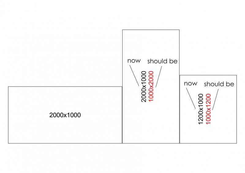

I´m working with the Code "Labelrec".
It works perfect, but is it possible to write always the lenght from the rectangle as first in the text line? e.g. when the length is smaller then the width.

Hi Lee,
Thank you for the answer.
Can you change the lisp file that
the text from the rectangle look like the example image file.
Thank you for your help.

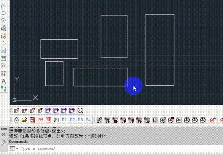

[XDrX-PlugIn(161)] Label Rectangle (theswamp.org)
https://www.theswamp.org/index.php?topic=59529.0
There are currently 161 plugins written, see:  https://www.theswamp.org/index.php?board=78.0
1. Eliminate unnecessary vertices
2. Modify the starting point to the lower left point (X is the smallest and Y is the smallest), and the clockwise direction is counterclockwise.
3. Align the text on the long side, and mark the text on the horizontal side first.
