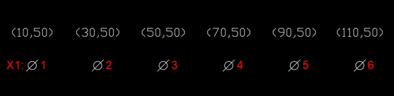

hanhphuc Posted March 26, 2018 Share Posted March 26, 2018 Note that such groups can be filtered directly from the ssget filter list FWIW, i prefer relational test pro: simple, reliable & efficient cons: no fuzz (setq [b] pl [/b]'((10. 50.)(20. 50.)(30. 50.)(40. 50.)(50. 50.))[color="green"]; point list[/color] ss (ssget (append (vl-list* '(0 . "CIRCLE,TEXT,INSERT"); filter '(-4 . "<OR") (apply 'append (mapcar ''((x) (list '(-4 . "=,=,*") (cons 10 x))) [b]pl [/b])) ) '((-4 . "OR>")) ) ) ) ) Quote Link to comment Share on other sites More sharing options...
