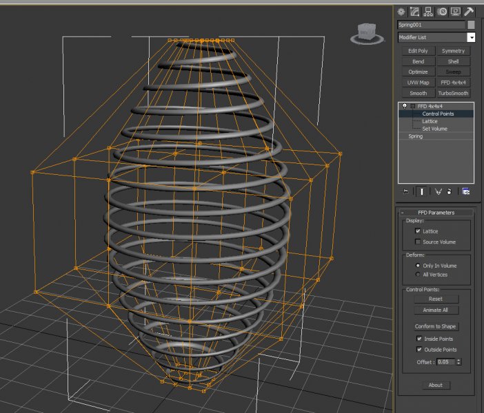

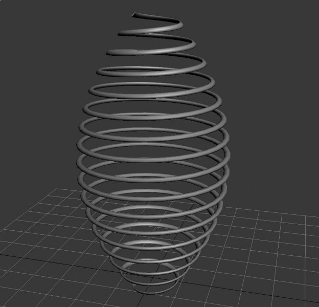

Cad64 Posted March 29, 2018 Posted March 29, 2018 I'm not sure exactly what you're trying to do, but I created the object below in 3ds Max using a Spring primitive object and then applied an FFD modifier. Is this what you're trying to do? I'm not sure how to do something like this in Autocad. I moved your question to the Autocad 3D Modeling section. http://www.cadtutor.net/forum/forumdisplay.php?20-AutoCAD-3D-Modelling-amp-Rendering Quote

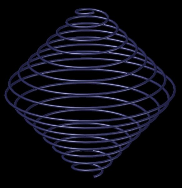

ReMark Posted March 29, 2018 Posted March 29, 2018 You could create such a model in AutoCAD...well actually half of it anyway then mirror and union it. The AutoCAD HELIX command allows the user to specify different base and top radii. Quote

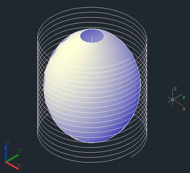

POPRivet Posted March 29, 2018 Author Posted March 29, 2018 Hello Mr Cad64 What I am trying to model is exactly what you have achieved. I am using Autocad 2017, not 3ds, so I cannot replicate your workflow. One of the attempts that produced the nearest results to what I want to do, was projecting an helix positioned outside an curved closed surface ( created by lofting three different diameter circles ), the external profile of the so produced surface is much like the spring “ you created. Unfortunately, after projecting the helix ( I tried the three different methods available in AutoCad ) the results were not as expected. The helix projection to the surface creates cross section ellipses ( closed splines ) not a spiral path along the prolate spheroid shape inside it. Only the “ Surface projection VIEW “ method worked, the “ Surface projection UCS/VECTOR “ methods did not projected anything. I am arriving to the conclusion that this is not a task AutoCad can perform, but if you ( or anyone ) reading this post come with new ideas I am always willing to try them. P.S.- Attached is a photograph of the method I tried to create the “ Oval “ spring. Best regards PR Quote

ReMark Posted March 29, 2018 Posted March 29, 2018 Since this is not a task that AutoCAD can perform I guess I'll delete my drawing. Failure sucks. Quote
POPRivet Posted March 29, 2018 Author Posted March 29, 2018 Since this is not a task that AutoCAD can perform I guess I'll delete my drawing. Failure sucks. [ATTACH]63647[/ATTACH] Hello Mr ReMark Thank you very much for your contribution. I am not completely sure that it can’t be done with AutoCad, but if it can, it is not obvious how to do it, at least for me. Your double conical spring model is perfect, but unfortunately it is not what I am trying to achieve. I would like to obtain a curved external spring profile. If you have more ideas, keep sharing please ! Any and every help is useful ! Best regards PR Quote
Cad64 Posted March 29, 2018 Posted March 29, 2018 I would like to obtain a curved external spring profile. The only way I was able to achieve this was by adding a modifier to the spring object in studio max. The modifier creates a cage around the spring with control points which can be grabbed and scaled in or out to create the curved effect, see image below. I don't know of any way to achieve this in Autocad, but then again, I don't use Autocad for 3D so maybe someone more knowledgeable would have some ideas? Quote
