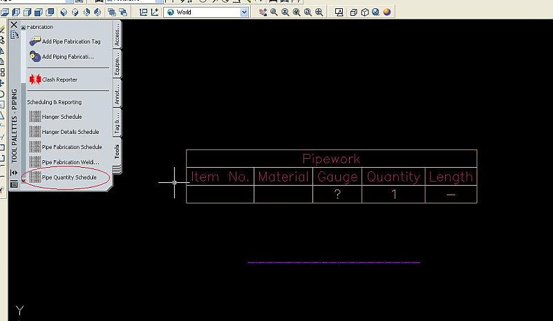

I'm also trying to use schedules to list my pipe lengths. In my tool palette I have the "Pipe Quantity Schedule". I'm trying to modify this schedule to include my pipe lengths as well, but all I end up with in that column is a dash. Any idea why?

Can you post the file?

Not much to post, I can just draw a pipe and the schedule would look like this using the option from the tool palette on the left.

The thing is, sometimes you have to go and edit the PSD in the Table Column. Right click the table, and select "Add All Property Sets" and see if that is an "easy fix". If not then you'll have to go into the table display properties, get rid of that column and add in a length property set manually. I know, it's ridiculous but just the way it is. :)
That actually worked, thx :) Now I just need to figure out the theory behind it all...

Glad it worked for ya. And honestly, it's pretty easy once you get over the learning curve. It's a fairly simple process. It's just a table column that you pick from a preset list of data (aka Property Set Data) That AutoCAD reads and displays. :)
Took me awhile to figure it all out. What sucks is that there is technically some limitations to PSD's and Schedules when you want to start adding some formula's to the mix for some custom table configurations. That's where I start pulling my hair out, lol.
