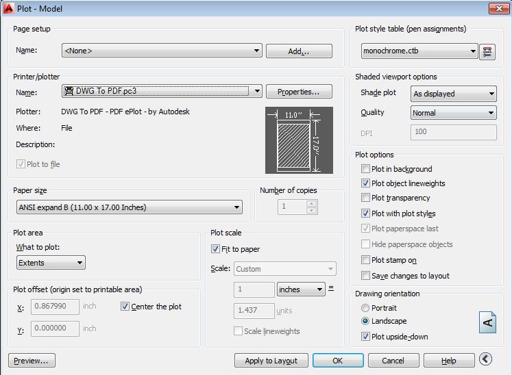

I have written a send a .dwg to .pdf routine and it is not working.
Here are the plot settings.
Any ideas?

rlx
I'm not sure because I haven't tested your routine but does it maybe fail on the paper size? You don't mention... I ask because I had this problem once and after I replaced the spaces in my paper size with underscores it worked...

BrianTFC
GregGleason,
try this.
(defun c:Test()
     (vl-load-com)
     (if (setq filename (getfiled "Save File Location" ""  "pdf" 1))
     (command "-plot" "yes" "" "DWG To PDF.pc3" "ANSI expand B (11.00 x 17.00 Inches)"
         "inches" "landscape" "yes" "Extents"
         "fit" "center" "yes" "monochrome.ctb" "yes" "a" filename "no" "yes")

rlx
Probably Brian's suggestion will work so just show where you went wrong:
to make the file name try his :
 (setq file (strcat (getvar "dwgprefix") (vl-filename-base (getvar "dwgname")) ".pdf"))
also :
 (setq s (getstring (strcat "\nEnter Filename for Save <" (getvar 'file) "> : ")))
file is not a system variable so it should be :
 (setq s (getstring (strcat "\nEnter Filename for Save <" file "> : ")))

GregGleason
GregGleason,
try this.
(defun c:Test()
     (vl-load-com)
That worked great BrianTFC! I appreciate the help.
