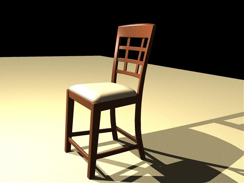

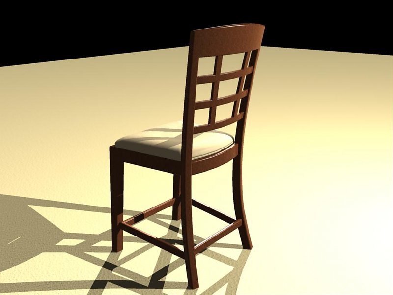

Ok, here's my attempt, hope it works with the jpg attached...
Really, it was not easy without any dimensions - everytime I re-opened the drawing I found something that "didn't look like it should". And I'm still not happy with the back of the chair... that arc didn't as I'd like to...:x
The pillow is also too small, it should reach the edges (I should have scaled it a bit). Materials and lights... well, my biggest problem!
Corrections and suggestions are obviously very welcome!
[ATTACH]9678[/ATTACH]
[ATTACH]9679[/ATTACH]

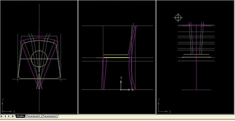

sir nice chair...
quick question how did you create the arc like back of the chair?
what command and what kind of method...
if its okay with you can you post a pick? id really like to learn how to create one..
Looks good. Now that chair looks rather lonely, so it needs its table. :wink:
I tried to help, but I guess it feels lonelier now!! :shock:
Seriously, thank you for the nice comments and feel free to give me also some advice / corrections to improve it (e.g. how to soften those sharp shadows...)
Arjun_samar, concerning your question:
After defining some general construction lines, I have drawn the profile of the back with two SPLINEs (I believe it is not a regular bow in the original chair). Then I had to convert the two SPLINEs in a surface and I extruded it on an horizontal bow. The whole back of the chair is a SLICE of this resulting solid (except the stick further down). You might understand me better with a screenshot of my construction lines (look at the pink lines)... a bit chaotic, I admit!
