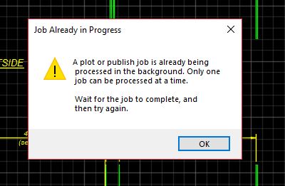

Can anyone tell me how to fix this? Instead of sending multiple drawings to the printer it will only print one at time before I can que up another one. I don't even know if this is a Cad issue.
Thanks
Turn off background printing and publishing and everything will speed up.
