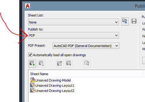

profcad
Good idea, what command to do all to PDF?
Use the PUBLISH command. Change the Output to PDF.

Sengna
wow that is awesome, I got the all PDF layout in one file, the only issue I have after converted to PDF is that, most of the border on title block on the right side were missing. is there a way I can set print area then convert to PDF?
