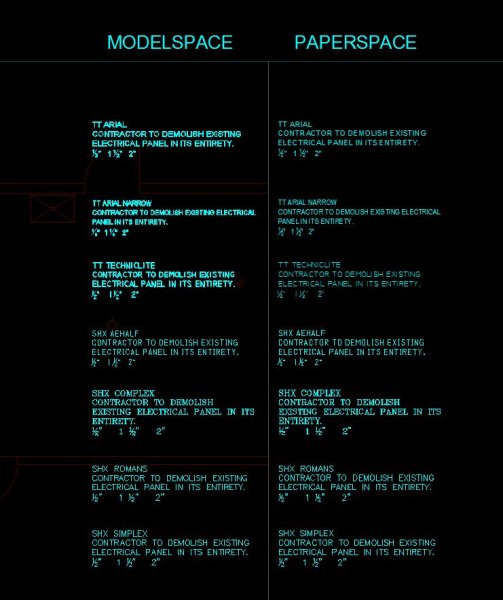

Long time SHX user struggling trying to convert to TT Font.
The very first and most evident issue I am facing is the fact that TT Fonts are being displayed (and consequently plotted) in different pen settings when using a viewport.
The printscreen below illustrates the issue: font sizes are proportional to the viewport scaling, by a factor of 48x (1/4" scale viewport). All MTEXT has a zero Z position. The printscreen shows (3) TT fonts on the top and (4) SHX at the bottom. TT fonts are not matching across the viewport/paperspace.
Any suggestion on what could be causing this?
This is valid on Autocad 2010 Full and Autocad 2017 Full.
Plotting also mimics the discrepancies found in the display.
Thanks in advance!

There is always a Z setting or a rotated UCS when TTF fonts appear fuzzy: double-and triple check again, or post your DWG file here to confirm.

1. In the TARGET model is not equal to 0.
Enter the command _view, you will see that the value is not 0
2. The scale of the viewport is not equal to the scale of the paper space.
When comparing different scales, the text changes.

Not "IT", it's called TARGET
I will say simply - your file is corrupted.
Copy texts to a new file. Check - no problem.

sample.dwgYour posted file is corrupt: also, if you want to write text in paperspace and want it to be the correct height to match your viewport (any viewport set to any actual scale), you need to explore using Annotative Text Styles.

You are correct, once I created a blank new file the issue went away. Not sure if I should try to understand what happened or just move on. I suspect this was related to the fact that I've been using the same CAD Template since AutoCAD 2007.

Okay, I need to revive this. Another drawing was looking fuzzy with the MS/PS fonts and when I went to check "TARGET", it read the following:
TARGET = -47'-10 41/64",36'-0 53/256",-0'-6 121/128" (read only)
I don't fully understand this command or what is causing these problems. Could someone help me with the following questions:
- what exactly is TARGET and what is it telling me?
- if I copy any linework from a drawing with a messed up TARGET, will this affect my current drawing, which has a TARGET=0?
- What else could cause TARGET to go off?
- Is TARGET related to 3D Drawings? If I know my drawings are purely 2D drawings (MEP work) could I turn this off, as to avoid these errors?
