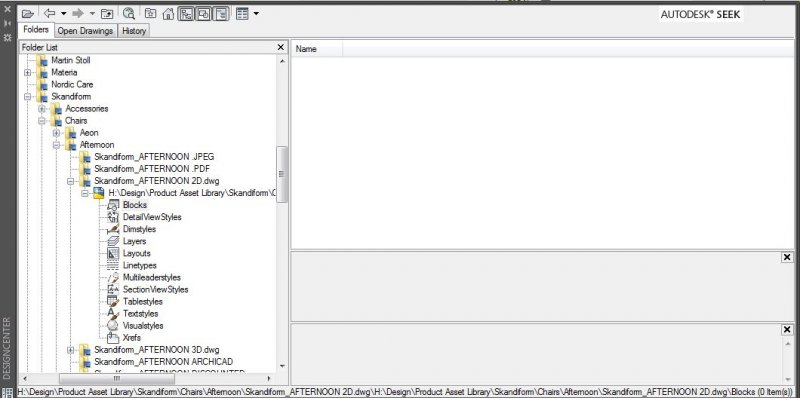

Hi All
Has anyone come across this?
I creating a new drawing blocks library. When I open DC, go down the tree to the folder location, it says I have 0 items in there. Further into the folder, it gives the full location address (which is where I've just been to get there). So it's referencing it's address twice?
There are no blocks, layers, nothing in it.
I can drag and drop my blocks from explorer.
I'm so confused. Why isn't DC working? It still works fine with my old drawing clocks library. Just not this new one.
Can anyone help?
Sorry All. I've solved the problem. Sorry to have wasted your time reading my post, but thank you.
Would you care to provide the solution to help others that might run across this problem?
LOL. Yes, some idiot had named the folder - blahblahblah.dwg.
Sigh!
So design centre was treating this folder as a dwg. It thinks it's a file type.
Never use dots in filenames.
Took me an hour to spot it.
