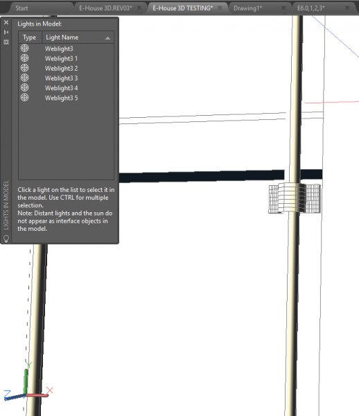

AmandaGao Posted June 11, 2018 Posted June 11, 2018 :cry: Hello, I have been struggling with the following: I have created a 3d modelling with the material and lightings assigned to, there is nothing shown after rendering, but dark screen... the outdoor view is no problem at all, but the indoor one only... Can anyone help with please... trying to upload the cad file, but exceed 1000Kb whatever I tried. Any hint would be appreciated! Quote

pendean Posted June 12, 2018 Posted June 12, 2018 If I take a door off your container then RENDER, it shows there is no light inside the container judging by all the shadows. Quote
AmandaGao Posted June 13, 2018 Author Posted June 13, 2018 If I take a door off your container then RENDER, it shows there is no light inside the container judging by all the shadows. I can see the lights for lightlist... what was the issue? Quote
AmandaGao Posted June 13, 2018 Author Posted June 13, 2018 I can see the lights for lightlist... what was the issue? Hi pendean, it works now after in change the intensity factor of lighting to be 10000... it shows up everything... Thanks and have a good day! Amanda Quote
