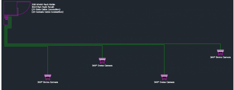

I have a electrical schematic drawing..but the lines are very close to each other. I want to increase the space between the lines..(stretch or something like that)... Is any possible to do that by lisp. Or please suggest me any possible ways.

Emmanuel Delay
elec2.dwg
I wrote something. It doesn't solve everything, but it can be a help to the file that you posted.
I'll provide my own simplified dwg.
Command: OL (offset lines)
- then type an offset distance (for my dwg pick 25, for your dwg 0.16)
- in a while loop, select each polyline.
* The first pline sets the base x-value
* The Each next vertical line will be "offset distance" to the right of the previous vertical line
This script expects polylines that first go horizontal, then vertical, then horizontal again (this last line is not required). So point 0 is the start, point 1 & point 2 are on the same x-value.
* notice: if the vertical lines are not exactly vertical *, this script will straighten them out.

So now you have to choose which polyline comes next.
It is possible instead to let the client select polylines, then sort the lines according to how left the vertical line is, if you need this, let me know.

acad1985
Thank you so much hanhphuc and Emmanuel for your Code.
I have tested your code with Sample file which is posted by Emmanuel, (elec.dwg)...it was working Perfectly.
But when i tried in mu DWG, i can't select the Line. Actually My file have some Blocks.
Please see Attached.
Test.dwg
Share this post
Link to post
Emmanuel Delay
The problem with that latest dwg is the 5 point polylines, because of the diagonal lines that go to the J blocks .
Both our scripts look only for 3-line (4 point) polylines, and we fix the middle one.
Well, my script fixes the second line, so you can add lines to the polyline as long as the vertical line is drawn as the second line.
What you should do:
- first make some room: with a stretch command you put the blocks a little farther apart. This gives our script some room to maneuver. Stretch them back at the end.
- trim everything to the right of those dashed line (unless we fix our script to also include this type of plans), I put the diagonal lines back in red; all detached from the polylines (see attachment).
Then both scripts work.
