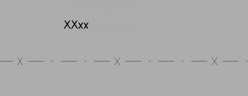

I've been trying to create a fence linetype, like this:
But something is going wrong that I can not do it.
Someone has one made or can do one and post it here?
Many thanks.

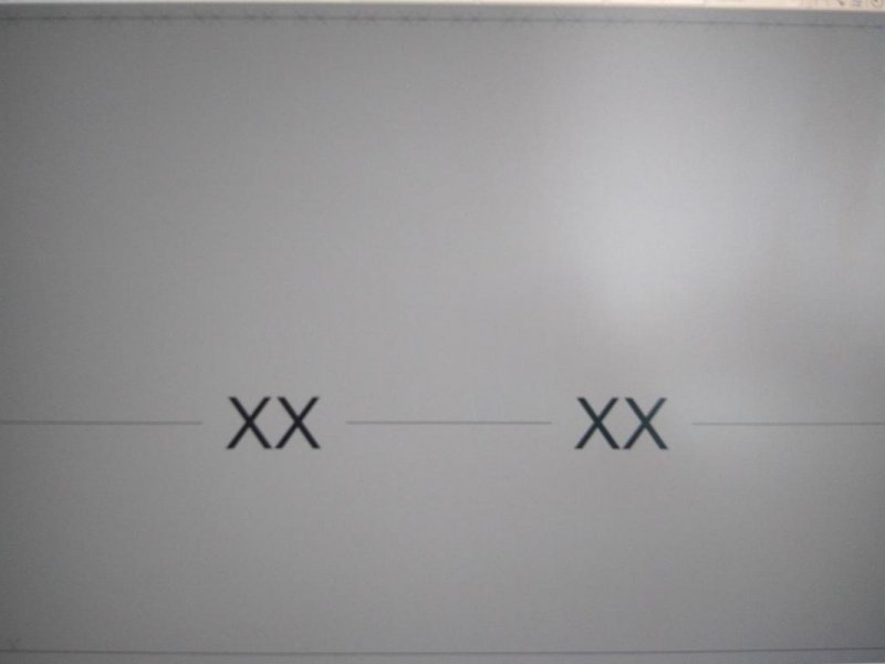

Here is a picture of one that I did earlier.

OK, but a picture is not really useful, a drawing would be more useful.
Are you using imperial or metric units? A scale does not mean anything, because you should draw full scale.
What you are trying to achieve is a complex linetype which uses a text character, because you can use the character 'X' for the shape.You must not use the Standard Text style, because if the font is changed, then the linetype may look different. Each font has its own dimensions.
Please find attached a small *.txt file. You will need to rename the file to XXLiso.lin to use. Within the file are two linetypes
FENCELINE2XMM an iso linetype for use in drawings units are millimetres
FENCELINE2XM an iso linetype for use in drawings units are metres
This part of the linetype controls the text. Change your text style here.
["XX",Standard,S=0.080,R=0.0,X=-0.080,Y=-0.040]
"XX" is the text to display
Standard is the text style. The text style MUST exist in the drawing into which the linetype is loaded otherwise it will error and refuse to load. The text height for the style must also be set to 0.
S= This is the text height
R= This is the relative text rotation
X= This is the text horizontal offset
Y= This is the text vertical offset
If you change the text style you may need to play around with the X and Y values to centre the text in the gap.
This is the line definition
A,600, -80,["XX",Standard,S=60,R=0.0,X=-60,Y=-30], -80, 640
