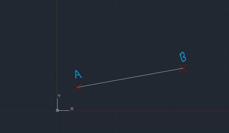

hello everyone, i want an autolisp function to get maximum and minimum coordinate in a polyline, such as below image A is min and B is max Coordinates that i want to get them.
A = (x,y)
B = (x,y)
thanks in advanced.

$0.02 - 'bounding box' should return min max as well
Such solutions will not necessarily yield a point on the polyline. ;)
oops, i misunderstood. In case polyline has bulge, i thought OP looking merely min max like bbox :oops:
