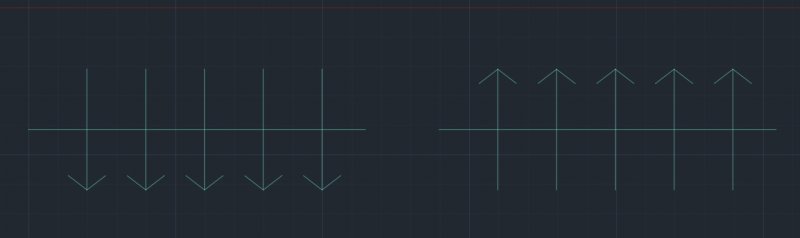

Capture.jpgHi all, i have a lisp that creates an array of blocks with defined spacing and a lisp that rotate blocks 18 0degrees. They both works great but i want t combine them into one lisp that allows me to choose for which direction the block should be facing.

I have assumed that your arrow block matches the block in the attached drawing.
Try the following, minimally tested with the attached block and NO error checking. Should work with arc's lines, splines and lwpolylines

To avoid the "flip line option think about this way pick the left end and arrows always get drawn in correct direction, Ok I know I can hear how do you know which direction the line is, simple you compare the pick point to the end picked and swap start end values if required.

The code was posted as an example of a simpler way around asking an extra question, in a suite of software we we adopted this method to save on manual entry, but the code above would mean remove the initget and set "yes or no" rather than make big changes to the code. You have startpoint and endpoint as part of the code, in the case of say a closed pline rectang it gets a lot harder so would just ask pick in or out. Need some time always time poor.
Ok found a few minutes tested pline, line, spline, does not work closed pline need an extra check.

thanks Bigal, this is great, i think im close to what i intended to do, just making it centered measure is the missing part..many thanks
Have another look playing with it now added a bit more save the extra dcl input as Getval1.lsp its a library routine and allows for any input with out hard coding.
Centre measure has been added and a dcl for spacing, also still need a think about closed.
Edited by BIGAL
Awesome! But I’m still having issues with orientation, would it be possible to keep the option where the user want to mirror or not?
Many thanks.
That is the whole idea by picking the correct end it goes in the right direction no need for a mirror. Draw a line, mes, pick left end, mes, pick right end. You will see the two answers appear.
