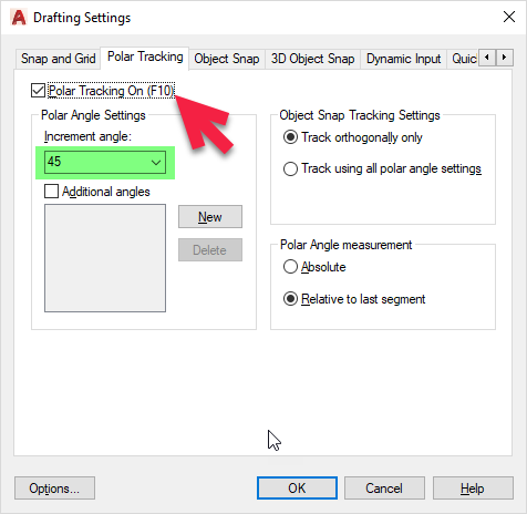

ronjonp Posted August 22, 2018 Share Posted August 22, 2018 F10 .. polar tracking: Quote Link to comment Share on other sites More sharing options...

Lee Mac Posted August 22, 2018 Share Posted August 22, 2018 Enable Polar Tracking and set APERTURE to 50. 1 Quote Link to comment Share on other sites More sharing options...
aban Posted August 22, 2018 Author Share Posted August 22, 2018 2 minutes ago, Lee Mac said: Enable Polar Tracking and set APERTURE to 50. This is great! It's the closest thing to what I want. Is there a way to not have any angle in between? If not, then this is fine as well. Thank you! Quote Link to comment Share on other sites More sharing options...
aban Posted August 22, 2018 Author Share Posted August 22, 2018 20 minutes ago, Lee Mac said: Enable Polar Tracking and set APERTURE to 50. So the problem with what I'm seeing is that the snapping also is bumped up quite a lot. Is there any way to keep the snapping to normal? Quote Link to comment Share on other sites More sharing options...
Cad64 Posted August 23, 2018 Share Posted August 23, 2018 9 hours ago, aban said: So the problem with what I'm seeing is that the snapping also is bumped up quite a lot. Is there any way to keep the snapping to normal? It's because you have APERTURE set to 50. Type APBOX at the command line and change the setting to 1 and you will see how large the aperture box is when set to 50. With the aperture box set that large, it's going to try and grab everything it gets close to. Quote Link to comment Share on other sites More sharing options...
Cad64 Posted August 23, 2018 Share Posted August 23, 2018 9 hours ago, aban said: This is great! It's the closest thing to what I want. Is there a way to not have any angle in between? If not, then this is fine as well. Thank you! I'm still not understanding how you're getting other angles. If you have the polar tracking increment angle set to 45, you should only be seeing 45 degree angle snapping. Quote Link to comment Share on other sites More sharing options...

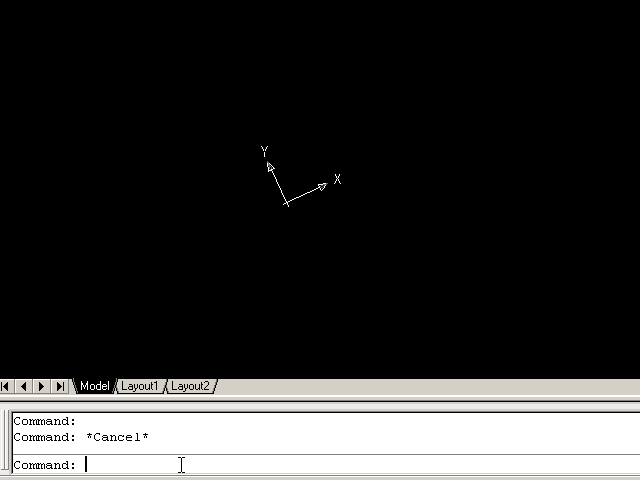

aban Posted August 23, 2018 Author Share Posted August 23, 2018 6 hours ago, hanhphuc said: hi, not sure but do you remember similar topic we discussed before? here. IMO perhaps OP's 'locking' effect like something orthomode or snapmode does? This is exactly what I want, where the angles lock at every 45 degree angle. I don't want the turned x and y axis though. I'm looking at the thread, but from the description dlanorh wrote, it seems like I need to draw a circle, arc or ellipse first which I'm not understanding why. I would like what the video shows, so instead of the word "test" at the command line I'd like if I could make it "DD". Also are you writing the different angles in or is it automaticlly going to the 90, 0, 45, 135, 180, etc degrees? I would like it to automatically snap to those degrees. Kind of like ortho, but in this case it's every 45 degree angles. I've done a little lisp before and have tried to understand that, but for the most part it's very difficult for me. This is the closest thing to what I want. Thank you!! Quote Link to comment Share on other sites More sharing options...
hanhphuc Posted August 24, 2018 Share Posted August 24, 2018 (edited) i recalled Lee Mac's LM:orthopoint ;LM:orthopoint (trans method) ;slightly mod (trans (getvar 'UCSXDIR) 0 1) ;to (trans (list c c 0.0) 0 1) where C, equals to (cos (* 0.25 pi)) On 8/24/2018 at 12:56 AM, aban said: This is exactly what I want, where the angles lock at every 45 degree angle. I don't want the turned x and y axis though. I'm looking at the thread, but from the description dlanorh wrote, it seems like I need to draw a circle, arc or ellipse first which I'm not understanding why. I would like what the video shows, so instead of the word "test" at the command line I'd like if I could make it "DD". Also are you writing the different angles in or is it automaticlly going to the 90, 0, 45, 135, 180, etc degrees? I would like it to automatically snap to those degrees. Kind of like ortho, but in this case it's every 45 degree angles. I've done a little lisp before and have tried to understand that, but for the most part it's very difficult for me. This is the closest thing to what I want. Thank you!! The GIF demo was just theoretically expressed possibility your 'lock' (ortho) behavior at 45d however we still prefer polarsnap mode which you are able to intersect within objects & input distance during command active etc.. (defun dd (/ foo p1 p2 p3 a b d grr) (setq foo '(( n / l a) ;octa (if (< 0.0 n 2.0) (caar (vl-remove-if-not '(lambda (x) (= 1 (vl-position 0 (vl-sort-i (cons n (list (+ (cadr x) 1e-15) (caddr x))) '<=))) ) (repeat 9 (setq l (cons (setq a (if l (mapcar ''((x) (- x 0.25)) a) (cond (a) ('(2.00 1.875 2.125)) ) ) ) l ) ) ) ) ) 0.0 ) ) p1 (getvar 'lastpoint) ) (while (and (setq grr (grread t 13 0)) (= (car grr) 5) (setq p2 (cadr grr)) (vl-consp p2)) (redraw) (setq a (angle p1 p2) b (* (foo (/ a pi)) pi) p3 (polar p1 b (* (cos (abs (- b a))) (distance p1 p2))) ) (grdraw p1 p3 1 0) (princ (strcat "\rOrtho angle = " (rtos (/ (* b 180.) pi) 2 0) " " ) ) ) (terpri) ;pause for user input (if (setq d (getdist "\nInput distance or <Enter> : ")) (setq p3 (polar p1 b d)) ) (redraw) (grdraw p1 p3 1 0) p3 ) ;was c:test changed to c:dd (defun c:dd nil (dd)) The command 'dd' only shows 'lock' effect and returns UCS coordinates nothing than that. maybe you can use it as modifier run transparently? Then 'dd' must be included in brackets, i.e: (dd) Command: pline Specify start point: 0,0 Current line-width is 0.0000 Specify next point or [Arc/Halfwidth/Length/Undo/Width]: (dd) Ortho angle = 315 (5.09256 -5.09256 0.0) or customize toolbar with macro: (dd) ? Edited August 25, 2018 by hanhphuc disabled html syntax color , 1e-8 , getdist Quote Link to comment Share on other sites More sharing options...
aban Posted August 24, 2018 Author Share Posted August 24, 2018 6 hours ago, hanhphuc said: i recalled Lee Mac's LM:orthopoint ;LM:orthopoint (trans method) ;slightly mod (trans (getvar 'UCSXDIR) 0 1) ;to (trans (list c c 0.0) 0 1) where C, equals to (cos (* 0.25 pi)) The GIF demo was just theoretically expressed possibility your 'lock' (ortho) behavior at 45d however we still prefer polarmode which you are able to intersect within objects & input distance during command active etc.. (defun dd (/ foo p1 p2 p3 a b grr) (setq foo '(( n / l a) ; octa (if (< 0.0 n 2.0) (caar (vl-remove-if-not ''( (x) (= 1 (vl-position 0 (vl-sort-i (cons n (list (+ (cadr x) 1e-8) (caddr x))) '<=))) ) (repeat 9 (setq l (cons (setq a (if l (mapcar ''((x) (- x 0.25)) a) (cond (a) ('(2.00 1.875 2.125)) ) ) ) l ) ) ) ) ) 0.0 ) ) p1 (getvar 'lastpoint)) (while (and (setq grr (grread t 13 0)) (= (car grr) 5) (setq p2 (cadr grr)) (vl-consp p2)) (redraw) (setq a (angle p1 p2) b (* (foo (/ a pi)) pi) p3 (polar p1 b (* (cos (abs (- b a))) (distance p1 p2))) ) ;_ end of setq (grdraw p1 p3 7 0) (princ (strcat "\rOrtho angle = " (rtos (/ (* b 180.) pi) 2 0) " " ) ) ) (redraw) (terpri) p3 ) ;was c:test changed to c:dd (defun c:dd nil (dd)) The command 'dd' only shows 'lock' effect and returns UCS coordinates nothing than that. maybe you can use it as modifier run transparently? Then 'dd' must be included in brackets, i.e: (dd) Command: pline Specify start point: 0,0 Current line-width is 0.0000 Specify next point or [Arc/Halfwidth/Length/Undo/Width]: (dd) Ortho angle = 315 (5.09256 -5.09256 0.0) or customize toolbar with macro: (dd) ? I'm sorry, I'm not the smartest when it comes to lisp language. I understood very little from what you said. I don't know what either lisp command that you posted is. I don't understand why that command wouldn't allow to input distance? I'm not sure what you mean when you said that with the command you can't intersect within objects. Is it possible to have a command that's exactly like ortho mode, except instead of 90 degree intervals it would be 45 degree intervals? So it would function exactly like ortho, but instead of snapping every 90 degrees it's 45 degrees? And in order to turn it on I wouldn't need to press "F8" I'd have to press "DD"? You might have answered my question in your response, but I don't understand what you said. Sorry in advance. I appreciate the help! Quote Link to comment Share on other sites More sharing options...
hanhphuc Posted August 25, 2018 Share Posted August 25, 2018 (edited) 14 hours ago, aban said: I don't understand why that command wouldn't allow to input distance? I'm not sure what you mean when you said that with the command you can't intersect within objects. but you can input distance after while loop , not exactly real time dynamically input distance. Intersect? example LM:grsnap function. Below snippet code updated in previous post , pause for user input. ;snippet (terpri) ;pause for user input (if (setq d (getdist "\nInput distance or <Enter> : ")) (setq p3 (polar p1 b d)) ) (redraw) (grdraw p1 p3 1 0) p3 Note: when you reply to include code , there's no need to quote the entire code, simply quote as snippet eg: (defun dd ... ) then understood, otherwise confusing if the original code gets updated. 14 hours ago, aban said: Is it possible to have a command that's exactly like ortho mode, except instead of 90 degree intervals it would be 45 degree intervals? So it would function exactly like ortho, but instead of snapping every 90 degrees it's 45 degrees? And in order to turn it on I wouldn't need to press "F8" I'd have to press "DD"? You might have answered my question in your response, but I don't understand what you said. Sorry in advance. I appreciate the help! IMO as suggested by Ronjonp is suffice, set 45d incremental angle polar tracking , it's not difficult to toggle F8 & F10 during drafting. why do you insist this ortho 45d ? ortho or polar is just a drafting aid same as my example code which command 'dd' or (dd) Edited August 25, 2018 by hanhphuc Quote Link to comment Share on other sites More sharing options...
