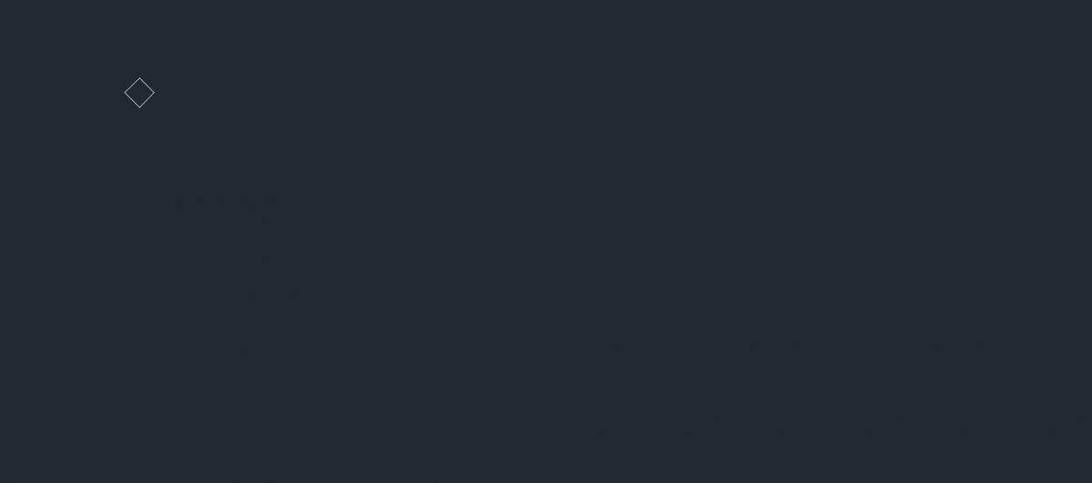

Revisiting this one today. For whatever reason I can't seem to find the resolution for this. I'm using a very simple block that is a rectangle rotated 45° angle to form a diamond shape. Inside this diamond is a single attribute called "MkNo". I would like to assign the value of "A" to the attribute in this block which is named MkNo.
NOTE: While I was playing around with the command line I actually got this to work. I checked the history and apparently I used up the history buffer and can't get the command I used back. It did insert the block with the letter "A" in it.

I hope I have finally resolved this. I don't recall what the original setting on the attribute was for "Preset". I do know that something I read made me toy around with this parameter but I didn't get the desired results. I set the Preset parameter to "NO" and then used this in the command window and all worked well. I also found that the code needed (setvar "ATTDIA" 0) and (setvar "ATTREQ 1).
(command "._-INSERT" "GLASS TAG" '(-200 200) "1" "1" "0" "B")

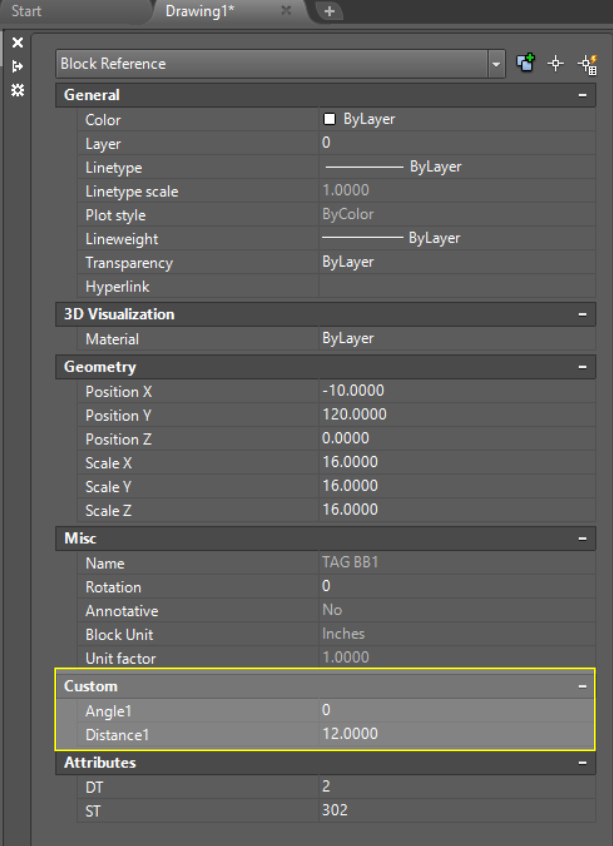

Still hacking at the Dynamic Block insertion this morning.  I am able to insert it and set values for the attributes "DT" and "ST" (see screen shot of the properties for this block). What I'm after now is to set values for the other two parameters which are shown under the "Custom" section of the properties, "Angle1" and "Distance1". I'm doing lots of searches and finding many similar topics but not quite the cigar I need for this project
This lisp and two sub functions will do as you ask. Unfortunately I don't think it can be done on the fly (without user input) as to set the values you need to get the values.
You can play around altering settings (top setq in main c:IBA routine) but this will only ever set the angle and distance to the hard coded values. You could read a set of (angle dist) from an external file. Code is documented.

(command-s "._-INSERT" "TAG BB1" pt1 0 0 "16" "16" "0" "2" "302")
  (SetDynProp (entlast) "Angle1" (dtr 180.))
  (SetDynProp (entlast) "Distance1" 12)
This is an on-the-fly project, with no user input allowed. This inserts the dynamic block with the two attributes "DT" and "ST" and the two Custom Properties of "Angle1" and "Distance1" assigned properly and without any pause or user input.
