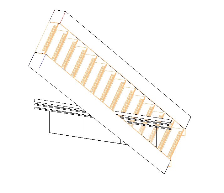

steven-g Posted September 19, 2018 Share Posted September 19, 2018 More and more we are getting models that come from Revit or Archicad(IFC) and my job is to get quantities from these, I admit that my skills with Revit are sparse but I can find my way around in a model. I have been asked to schedule the staircase railings and hand rails in a project, these are not modelled. So trying to add these in using Revit I tried adding railings to host, but for some reason the stairs although showing as being a stair under properties are not recognised using the add railings tool, I also have no idea how to add railings using the sketch feature. Drawing lines only works (for me) if you first set a working plane and these stairs have no selectable points I can find to draw along the strings, they also have no lines selectable to select existing geometry, and besides that there are over a hundred staircases and not many are either the same size or even the same orientation. After wasting half a day watching videos and trying various things, I have exported the stairs, walls and floors to DWG and I'm doing this in Autocad, which is so easy using 3dpoly. Is it really so complicted and time consuming in Revit do I have to set a workplane for every twist and turn, or am I missing some simple tricks, all I need eventually are linear measurements and in Autocad it's just a question of pick pick pick done. But it would be nice to have that in Revit so that my collegues can check it using solibri. Attached is one of the stairs just in case I'm doing something wrong with the railings by host option. Stair.rvt Quote Link to comment Share on other sites More sharing options...

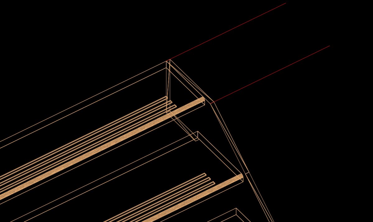

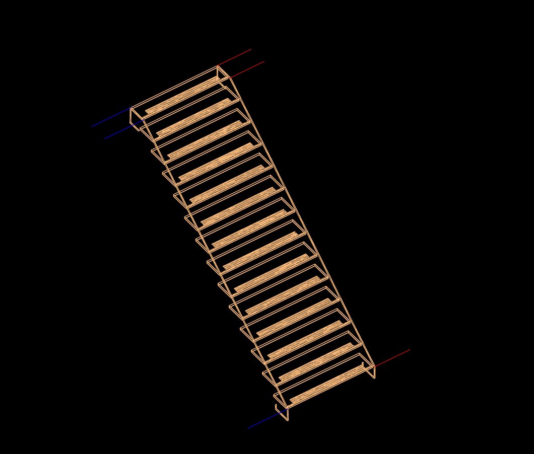

marmo Posted October 23, 2018 Share Posted October 23, 2018 Sorry for your late reply, you probably will have already finished the job ... Anyway it's an interesting post and I want to give my solution. The approach is this: The railings can be hosted by stairs, floors, ramps and toposurface. So it could be done this way, using toposurfaces. 1) export to autocad. 2) draw some lines you'll use to generate the 2 toposurfaces (on 2 separated layers, blue and red in the pictures). 3) import in Revit and generate the 2 different toposurfaces. 3) draw the parapet. 4) indicate the two toposurfaces as the new host. 5) hide the toposurf. It remains however a cumbersome solution, but allows you to have the railings in revit. Quote Link to comment Share on other sites More sharing options...

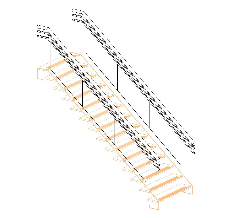

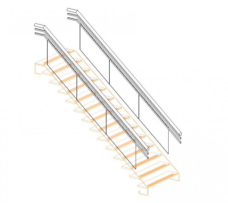

marmo Posted October 25, 2018 Share Posted October 25, 2018 You can do this by loading the stair into the conceptual mass environment. It's better for the kind of job you want to do. For the parapet you can create a family based on adaptive points that can reports the parameters of the perimeter, area and some lengths ... So: 1) new conceptual mass family (you have 3d snap option, reference lines etc) 2) import the stair ---> i suggest to import a cad file where the stringers are fixed, it's enough to draw some lines on the existing geometry to allow the snap when you import the file. 3) built a separate family for the parapet based on 3 adaptive points with parameters where you can set, height, materials etc, and some reporting parameters for area and dimensions. 4) otherwise you can draw directly in the family where you imported the dwg of the stair, like in the image below. 1 Quote Link to comment Share on other sites More sharing options...
