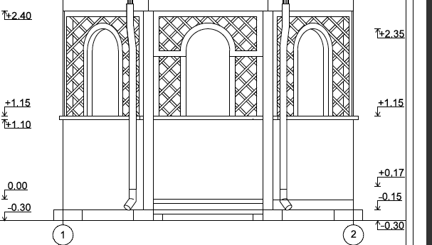

Hello.
Can you tell please, how to draw hard elements in AutoCAD in perspective.
It takes some time, you need to draw everything yourself, it's different than ArchiCAD.
How to get use with this after ArchiCAD?

Well to be fair you can't/shouldn't compare ArchiCAD to vanillia AutoCAD. ArchiCAD is more like AutoCAD Architecture. Why do you need to draw those in perspective?

Drawing in perspective? That's what 3D models are for.
If you build a 3D model, you can then rotate around and view it in perspective from any angle. If you draw something in perspective, that's it. You're stuck with that view only.

Draw the view 2D in front view.
Rotate 45 degrees around the Y-axis.
perspective 2D view. 😉
give all lines a thickes for the depth..

No thats not perspective, the true interpretation would include a vanishing point.

When you change the 'viewcube' mode from parallel to 'perspective', itll use the vanishing point?

Thank you for the answer. I was using ArchiCAD, nowadays need to work in AutoCAD. That's why :)
Not so easy to remember geometry subject and drawing in perspective.
