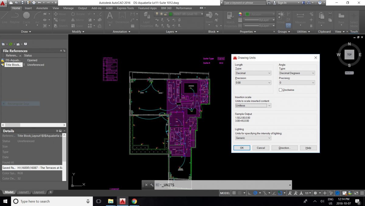

ponyboy 10 Posted October 7, 2018 (edited) Hi Everyone, I received a CAD drawing from an architect and the drawing does not appear to be metric or imperial. When I check line lengths I get very odd numbers... When I open up the drawing units window, length & angle is set to decimal and insertion is set to unitless. I'm also unable to print the drawing to scale either. Opening file in AutoCad 2016. I have never received a file like this and I'm at a loss as what to do in order to convert it. Please help! Thanks! Edited October 7, 2018 by ponyboy Share this post Link to post Share on other sites

ponyboy 10 Posted October 8, 2018 16 hours ago, BIGAL said: What does some known distance of say a door show ? Does it make any sense ? Did you insert the dwg a problem is that a metric dwg inserted into a feet dwg can do some screwy things its a factor of 1/0.3048 a foot to 1 metre. The door is reading as 6.48 - that's an example of the odd numbers I mentioned. I just opened up the original CAD file. 8 hours ago, SLW210 said: Try https://knowledge.autodesk.com/support/autocad-architecture/learn-explore/caas/CloudHelp/cloudhelp/2018/ENU/AutoCAD-Architecture/files/GUID-652DA67D-C364-43C6-A71D-FD1E676A0374-htm.html I will try this. Thank you. 7 hours ago, rkmcswain said: Did you insert or xref the drawing into another one? Are there no dimensions in the drawing that you can compare to actual measurements? Did you ask the drawing author? I did not insert. I know that the counter depth is about 24 - 26 inches - the line reads as 5.2 I did not ask the drawing author because I don't know if this is an obvious fix and prefer not to look incompetent. Also I want to figure this out myself...and by myself I mean you guys to help me lol. 7 hours ago, RobDraw said: This is the key to the solution. A "very odd" number compared to a known length will tell you how to proceed. Have you changed the units and see if the numbers make sense? I have changed the units and the lines still read the same. I am happy to send the cad file if anyone is up for the challenge. Share this post Link to post Share on other sites

rkmcswain 45 Posted October 8, 2018 I noticed that several of the blocks were set to 0.4 scale. So if you scale the entire drawing up by 10/4 to get the blocks to 1.0 scale, a lot of the doors now measure 17.2 So you know that is not inches, or feet, or yards, and no factor of this (1720mm, 172cm, 17.2dm, or 1.72m) would equal anything close to an interior door size. Anyone else got any ideas? Share this post Link to post Share on other sites

steven-g 35 Posted October 9, 2018 If you resize the whole thing so that the kitchen cabinet doors are 610mm then everything else looks to make more sense. Which is a scale factor of exactly 125 1 Share this post Link to post Share on other sites

ponyboy 10 Posted October 12, 2018 On 10/9/2018 at 11:37 AM, steven-g said: If you resize the whole thing so that the kitchen cabinet doors are 610mm then everything else looks to make more sense. Which is a scale factor of exactly 125 Yes this totally worked!! I had them send me a corrected file just to be certain and compare. Thanks! On 10/10/2018 at 3:27 AM, eldon said: How very percipient of you. As a further feature, if one plots that drawing on an A4 at 1 to 1, one can use a 1 to 125 imperial scale rule to measure the size of the apartments in feet - very handy for developers advertising new build for sale. Very cool, did not know that. For your amusement this was the response when I requested the correct drawing: "Apologies. Something must have been omitted when the file was extracted, we have revised the file now, please see attached for your usage." Thanks for everyone's help! Share this post Link to post Share on other sites
