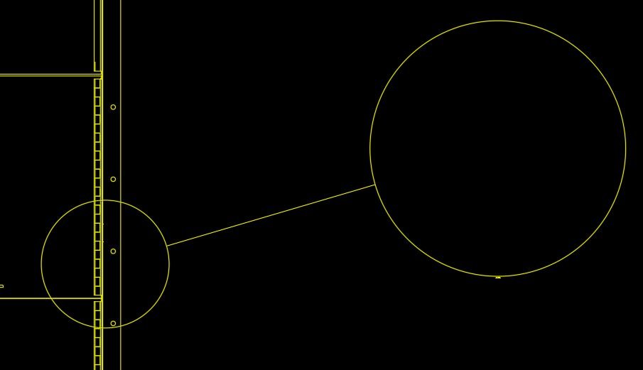

lisp routine not working:
cadmando-2
  • I have used this "Detail.lsp" off and on for years now. and now for some reason it not working.
This detail.lsp would create scaled details.
Now it’s not working right!

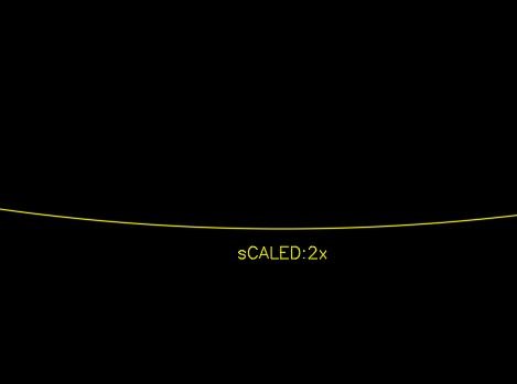

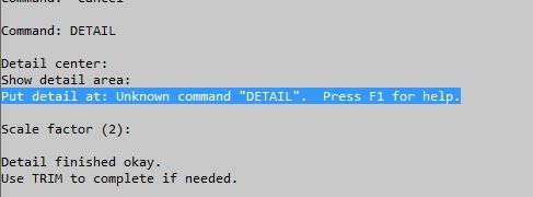

  1. Creates the two detail circle, but no detail! Second it is showing in command line “Put detail at: Unknown command "DETAIL".  Press F1 for help.” Never done that.
  2. It has always made the scale lower caps “sCALE:”

Quick glance on this...
Theres no closing double-quote, aswell a right-bracket in the first row: (prompt "\nDETAIL")
Also you might want to remove the dash "-" from here:
(defun C:DETAIL- ( / P1 EN EL PTS SS1)
Edited by Grrr
Ya,
The "-"
I copy and rename it so I wouldn't over right the original file.
Still having same error"😦
GRRR
This works fine on other co-worker PC but myself and one other co-work, we get the same error and doesn't finish, but is blank in 2x center? confused.
and it keeps coming up "Detail" unknown command, but again works fine on one pc fine.
just can't figure it out...🙄 funny thing is, it worked at one time?
Edited by cadmando-2
Just a hunch but try changing
(defun C:DETAIL( / P1 EN EL PTS SS1)
 to
(defun C:DETAIL ( / P1 EN EL PTS SS1)
      insert a space here
First thing I'd do is cleanup all those global variables ...

Still not working. can't figure it out. it works fine on co-workers AutoCAD Mechanical 2019, but on two of us on ACAD Mechanical 2018 not working.
it was at one time and didn't ACAD at all, not even service packs. it just doesn't finish and copy the object in the circle. and I even exploded the block to.
completely puzzled over it!  working 50 hour day now for 8 months and no extra time to sit down and figure it out. up against dead lines just no time and would be nice if it was working.
only change was "AutoCAD Mechanical 2018 WBLOCK Hotfix".
https://knowledge.autodesk.com/support/autocad-mechanical/getting-started/caas/screencast/Main/Details/92e3312b-aaa7-4fdd-8080-b77ca944b1c6.html
(defun c:foo (/ _c ad b bd bn d e p p2 s sc)
  ;; RJP » 2018-12-10
  (defun _c (p r) (entmakex (list '(0 . "circle") (cons 10 p) '(8 . "detail") (cons 40 r))))
  (cond
    ((and
       (setq p (getpoint "\nPick center of detail: "))
       (setq d (getdist p "\nEnter radius: "))
       (setq p2 (getpoint p "\nPick point to place detail: "))
       (setq sc	(cond ((getint "\nEnter scale of detail <2>: "))
		      (2)
       (setq s (ssget "_C" (list (+ (car p) d) (- (cadr p) d)) (list (- (car p) d) (+ (cadr p) d))))
       (setq s (vl-remove-if 'listp (mapcar 'cadr (ssnamex s))))
		 '(lambda (x) (wcmatch (cdr (assoc 0 (entget x))) "INSERT,MTEXT,TEXT,DIMENSION"))
		 s
     (setq bn (strcat "Detail_" (itoa sc) "_" (rtos (getvar 'cdate) 2 12)))
     (setq ad (vla-get-activedocument (vlax-get-acad-object)))
     (setq bd (vlax-invoke (vla-get-blocks ad) 'add p bn))
     (vlax-invoke ad 'copyobjects (mapcar 'vlax-ename->vla-object s) bd)
     (setq b (vla-insertblock (vla-get-modelspace ad) (vlax-3d-point p2) bn sc sc sc 0.))
     (_c p d)
     (_c p2 (* d sc))
     (vla-put-layer b "detail")
     (command "_.polygon" 100 p2 "_I" (* d sc))
     (setq e (entlast))
     (command "_.xclip" (vlax-vla-object->ename b) "" "_New" "_Select" e)
     (entdel e)
     (entmakex (list '(0 . "line")
		     (cons 10 (polar p (angle p p2) d))
		     (cons 11 (polar p (angle p p2) (- (distance p p2) (* d sc))))
		     '(8 . "detail")
     (entmakex
       (list '(0 . "TEXT")
	     '(100 . "AcDbEntity")
	     '(67 . 0)
	     '(8 . "detail")
	     '(100 . "AcDbText")
	     (cons 10 (setq p2 (polar p2 (* pi 1.5) (+ (* d sc) (* 2.5 (getvar "TEXTSIZE"))))))
	     (cons 40 0.125)
	     (cons 1 (strcat "sCALED:" (itoa sc) "x"))
	     '(50 . 0.)
	     '(41 . 1.)
	     '(51 . 0.)
	     '(71 . 0)
	     '(72 . 1)
	     (cons 11 p2)
	     '(100 . "AcDbText")
	     '(73 . 0)
(vl-load-com)
I tried to somewhat translate your code. It could still use some cleanup but hopefully will give you a working base.
Edited by ronjonp
Thanks ronjonp
I works. is there away to see the first circle.
I guess you could even change the circles to rectangle.
thank thank thank!
still would like to know what change on two PC that wouldn't allow the first detail.lsp not to work.
Thanks again
