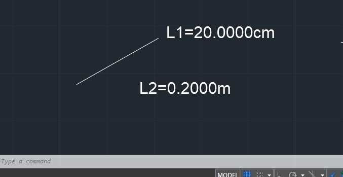

i have this lisp that show me the length of line.
but it show it only in cm.
i want that it will ask me if to present it by meter or cm.
something like this option to choose from
i hope you can help me :)

Edited by alat
If you look at this line (setq fmt "L*=%lu6%pr2 cm") it hold the formatings without testing  lu6 length units 6 = "current units",  precision 2 decimals need to change units or divide the length by 100 to be metres. So do a if m or Cm then set fmt to suit. If you do a mtext select field pick an object and you can see the text changing
Download my original Length Field program.
Replace lines 63-65:
    (setq fmt "%lu6" ;; Field Formatting
          tag nil    ;; Optional predefined attribute tag
With:
        (lambda ( / tmp )
            (if (null lf:inc) (setq lf:inc 1) (setq lf:inc (1+ lf:inc)))
            (if (null lf:unt) (setq lf:unt "Meters"))
            (initget 6)
            (if (setq tmp (getint (strcat "\nSpecify length ID <" (itoa lf:inc) ">: ")))
                (setq lf:inc tmp)
            (initget "Meters Centimeters")
            (if (setq tmp (getkword (strcat "\nSpecify units [Meters/Centimeters] <" lf:unt ">: ")))
                (setq lf:unt tmp)
            (setq fmt (strcat "%lu6%ps[L" (itoa lf:inc) "=," (if (= lf:unt "Meters") "m]%ct8[0.01]" "cm]")))
Edited by Lee Mac
thank you lee mac. i love your lisps!
i wish to know half of your knowledge in programming.
the complete code for those who wants:
You're welcome.
Please note that the modifications that I suggested should be implemented in my original program, not your modified version.
I noticed, but i still want the modification i have. There is a way to do that without any problem.
Cause know it makes the result divided by 100
after puting the code you gave me into your original code.
i draw a line of 20 m, i tried the lisp, and it divided the result by 100
Edited by alat
I thought this was the intention? (1cm = 1/100m)
If not, simply remove this:
%ct8[0.01]
Edited by Lee Mac
my intention was 20m = 2000cm.
the code you gave me was like that : 0.2m = 20cm - its true but divided by 100
so when you suggest removing the "%ct8[0.01]" i understand how to fix it.
(setq fmt (strcat "%lu6%ps[L" (itoa lf:inc) "=," (if (= lf:unt "Meters") "m]" "cm]%ct8[100]")))
now its working the way i like.
thanks for everything :)
