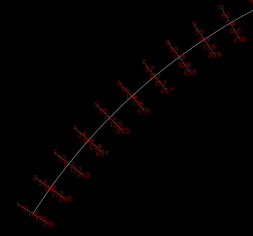

There is a lot of great numbering programs for cad (i.e. Incremental Numbering by Lee or Increment by Gile).
But I didn't found any numbering suite that will allow me to pick path (i.e. as lwpolyline) and number in accordance to this path.
Drawing below shows what I would like to achive.
I have only one question, how to recognize, on which side of my path is circle to number (top/bottom/left/right etc.)?
For sorting along curve (lwpolyline) I will use function vlax-curve-getClosestPointTo  and vlax-curve-getParamAtPoint.
For now we can assume that path is made with line object.
@ronjonpthere is no code to generate this, I did this manually to show what I want to achieve
@maratovich in my drawing I have circles and text. Lets assume that I will work with circles.
Generally I need only idea how to sort "rows" in reference to selected path.
I would start like this.
It doesn't tell you left, right... but it tells you the distance along the path.  Whomever drew the path, where the polyline started is distance 0. That's where the low number should be.
This can be reversed if needed.
This script just prints that distance (along with other data) on screen.  Your 1 real question was to get this, right?
I assume the circles are blocks with an attribute.
dwg in attachment

Not very pretty but this may give you a start. It currently inserts text.
(defun c:foo (/ a aa b c d e l ll n p pa)
  ;; RJP » 2018-10-12
  ;; Divides a polyline into segments then divides another distance at each of those
  ;; points while incrementing a number by 1. Polyline direction will dictate what
  ;; side the numbering starts on. Happy Friday!

thanks @ronjonp for tip.

and example:
