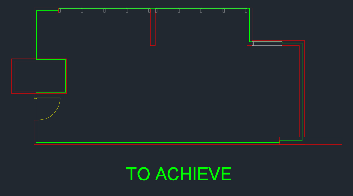

Hi Everyone,
Needed some help here. I needed a lisp that can create polyline at the middle of every two parallel lines that I selected. The subsequent polyline created will automatically chamfered with the previous created polyline. I'll try my best to illustrate below:
When I select line A and line B a polyline will be created in the middle of the two lines. Then I continue to select line C and D another polyline will be created in the middle and it automatically chamfers with the previous created polyline (at distance 0) to form a continuos polyline, and so on. Refer to the 'After' image to understand the end result (generated polyline in green).
However there are some issues that need to be tackled in order to achieve what I needed as follow:
1) The lines that I need to select (i.e. A to H) can be in the form of normal line, polyline, part of a rectangle and sometimes they are within a block or nested block. Hence I must be still able to select these lines individually instead of end up selecting the whole rectangle or block.
2) When comes to a T-junction situation there needs to be a way for me to choose which side (eg. left or right) the polyline should chamfer to.
3) I need an option/ button to switch to normal polyline command during the process, and also switch back to this lisp command as and when during the process.
It would be very very helpful if such lisp can exist.
Any help would be very much appreciated. Many thanks in advance!

JCYK
Hi Lee Mac, thanks for responding.
I do not know how to create lisp code and hope a kind expert would be able to help.
Hope my illustration and explanation is clear enough for everyone, if not pls let me know. It's purpose is actually similar to what M2P function does but the latter is too tedious and time consuming. Hence I'm proposing this method to suit the drawing condition and complete the task faster.

JCYK
Hi BIGAL, Grrr and all, hope everyone is well.
My sincere apology for my absence. I was rained with submission datelines one after another and forgotten to get back to this one!
@BIGAL I tried your code and I would say it's almost there for straight forward situation! Only sometimes the function is not performing correctly hence I've done extensive trials to find out in what situations causes the problem. Here's what I found:
1. When the view is too small (i.e. zoom out too much) when using this lisp the chamfer will not perform correctly. (this is not a big problem if cannot be fixed)
2. The 2 lines that I'm going to select and the 2 lines that I last selected (to create middle line) needs to have min. 50% of it's length visible in the model view. If not the 2 middle lines won't chamfer. (will be great to fix this as sometimes there will be 2 lines close to each other and we'll need to zoom in to select them)
3. When comes to T-junction situation where for example left side is shorter than right side the lisp will by default create middle line at the longer side which is not always what we wanted. (Is there a way for me to choose which side the middle line should be created? For example the middle line will be created base on the side (left or right) I select when selecting the 2 lines.)
Other issues and improvements:
4. There will be situations where the layout plan has a thick wall and thin wall side by side. The middle lines created for the thick and thin wall are not able to chamfer as they are parallel to each other. However I need the 2 middle lines to be connected to form a continuous polyline as shown in below screenshot. Can this be done?
5. Can the lisp allow an option for me to use polyline as and when needed to help create my desired enclosed polyline? Meaning I can always able to choose between 'select 2 lines to create middle line' or 'continue with drawing polyline'. This will provide great flexibility to handle all kinds of situation, including item 6 above.
6. The middle line created is not a polyline. Can you make it a continuous polyline by default and also line with of 10 to make it more visible?
7. There seems to be no option to chamfer the last created middle line to the first one that I created when I've finished creating the enclosed middle lines.
8. Once I entered the lisp command, it also turned off OSNAP. Can leave the OSNAP on so we don't have to keep turning it back on? Will need it in order to select the lines accurately.
I attach herewith a layout plan dwg with middle polyline that I need to achieve for your reference.
Do let me know if you need any clarification.
Thank you very much in advance!!

Just as start point a bit tricky to select paired lines as shown
