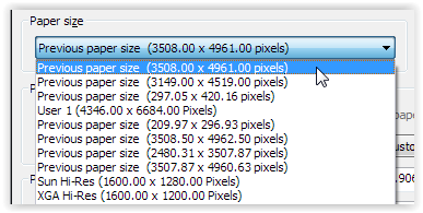

BIGAL Posted December 10, 2018 Share Posted December 10, 2018 Using Plot and the option "publish to web" JPG. Ok now the tricky bit use at least the Sun 1600x1200 res, we use a custom pixel ratio up around 4000 pixels to get very sharp images, You need to work backwards on your sheet size at say 200DPI A1 Metric to complicate is about 6456 pixels x 4488. Quote Link to comment Share on other sites More sharing options...

Cad64 Posted December 10, 2018 Share Posted December 10, 2018 2 hours ago, PJ01 said: Not sure how to get tha better resolutiont in a couple of simple steps, anyone help please? Does it have to be a jpg? The jpgout command is going to be the worst possible option in terms of resolution. What about printing to pdf or dwf? Or try what bigal suggested and "publish to web" with either the jpg or png option. You could also export a .eps file. Here's a tutorial on how to set up and plot to .eps: https://www.cadtutor.net/tutorials/autocad/autocad-to-photoshop.php Quote Link to comment Share on other sites More sharing options...
PJ01 Posted December 10, 2018 Author Share Posted December 10, 2018 (edited) Thanks Cad64. The item is in a jpeg format to be sent to an engraver who will cut out the escutcheon plate with a laser, so the more accurate the better. Will give the suggestions by BIGAL a go. Will also chase the engraver to see if they can handle the pdf version Edited December 10, 2018 by PJ01 Quote Link to comment Share on other sites More sharing options...
