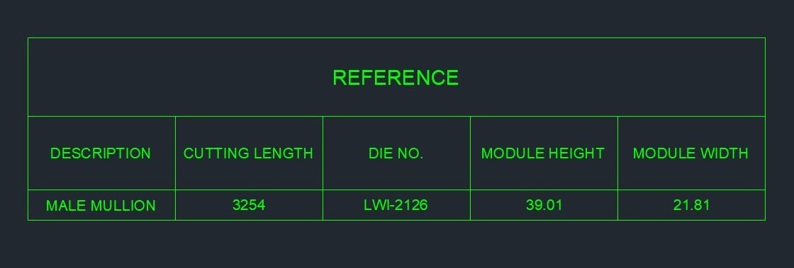

Hello guys, I'm here again asking for help to this routine. I want to copy the text in the leader and paste it on the table cells in this manner (See photos):
1. pick leader with text
2. select cell 1 to paste the first line of text with.
3. select cell 2 to paste the second line of text with.
4. select cell 3 to paste the third line of text with.
and so on and so forth.
I have this code in mleader, i dont know if it will help. This leader comes from combination of block attributes and dimension entities.

BTW. I used the getattributevalue for block entities created by @Lee Mac. Thanks to this. It really helped me a lot.
Thanks in advance. :)
PS: Please do it as simple as my code. Im new learning this lisp thing. Thanks ^^. hehe

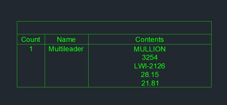

Btw. I used data extraction. But it gives me this since it only have 1 content. PIC3.thumb.JPG.df14f1fa0d0571e0a3d449980626d1bd.JPG
Is it possible to break it as individual content to have distinct cells for each content? Thanks. :)
