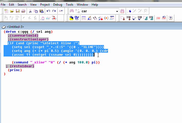

TunzaGibbo Posted December 20, 2018 Author Share Posted December 20, 2018 I'm just not getting this. This is "Getting too many arguments" (defun c:qqq (/ sel ang) ;(savevartoold) ;(constructionlayer) (if (and (princ "\nSelect Xline :") (setq sel (ssget "_+.:E:S" '((0 . "XLINE")))) (setq ang (+ (* pi 0.5) (angle '(0. 0. 0.) (cdr (assoc 11 (entget (ssname sel 0))))))))) (command "_xline" "A" (/ (* ang 180.0) pi)) ; (restoldvar) (princ) ) Quote Link to comment Share on other sites More sharing options...
Tharwat Posted December 20, 2018 Share Posted December 20, 2018 Hope you can get it from the following demo. Quote Link to comment Share on other sites More sharing options...
TunzaGibbo Posted December 20, 2018 Author Share Posted December 20, 2018 yes I have got now I have included the command line in the if statement and it works. Just have to get the subroutines fixed now what would change if I wanted the to select a line or a xline Quote Link to comment Share on other sites More sharing options...
