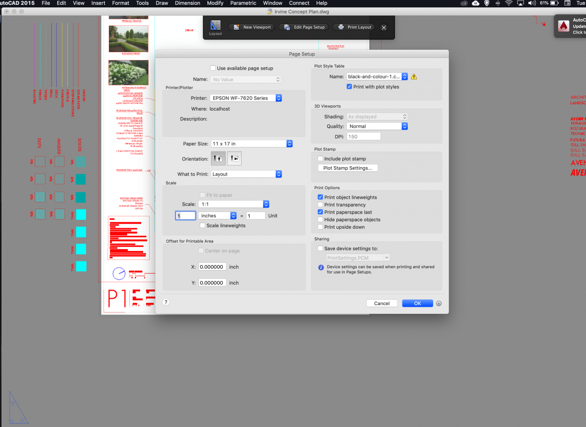

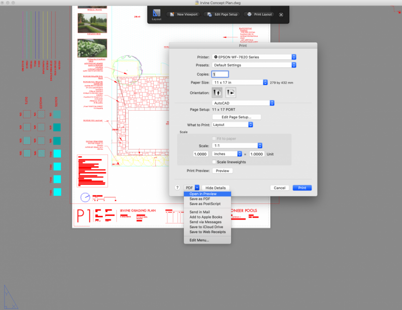

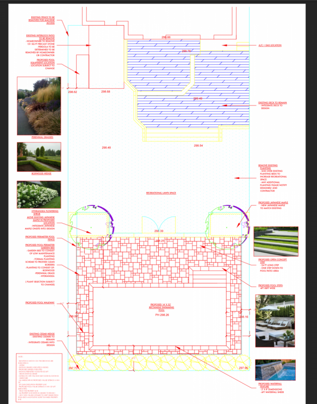

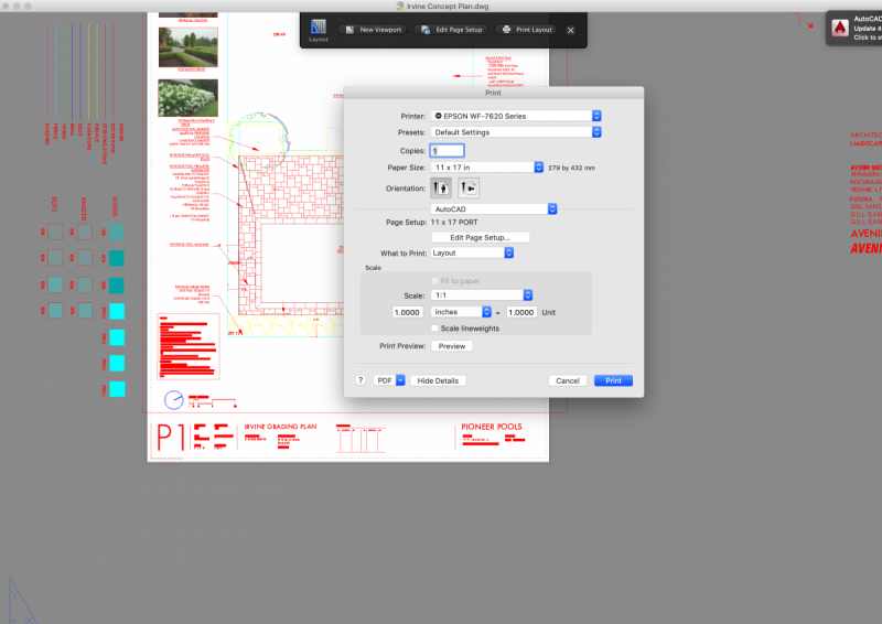

I've been trying to plot a simple landscape drawing and the output of the drawing always shows in color.
538622370_ScreenShot2019-01-15at10_07_07PM.thumb.png.76fb17c6b3e087712575da5d83c60c1f.png703732983_ScreenShot2019-01-15at10_07_19PM.thumb.png.aedd2e1cb32057045192a8deec108d1f.png495766311_ScreenShot2019-01-15at10_07_29PM.thumb.png.850db28eadc5d23df190a2dfc8f70b39.png539403183_ScreenShot2019-01-15at10_07_41PM.thumb.png.4ce0f5cb29382ff4690b21a56ed2a48a.png

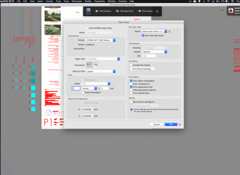

under 'Plot style table' - "print with plot styles" check box is checked..
i've uploaded some photos to help.

Hard to say without having the plotstyle to look at and the .dwg. True Colors will plot in color and so do color images, unless you set the printer's drivers to only plot in B&W.
What exactly are you trying to plot "not in color"?
There is a warning symbol next to the plot style making me think that the drawing is set for stb but it is looking for a ctb.  Confirm if that is the case or not.
