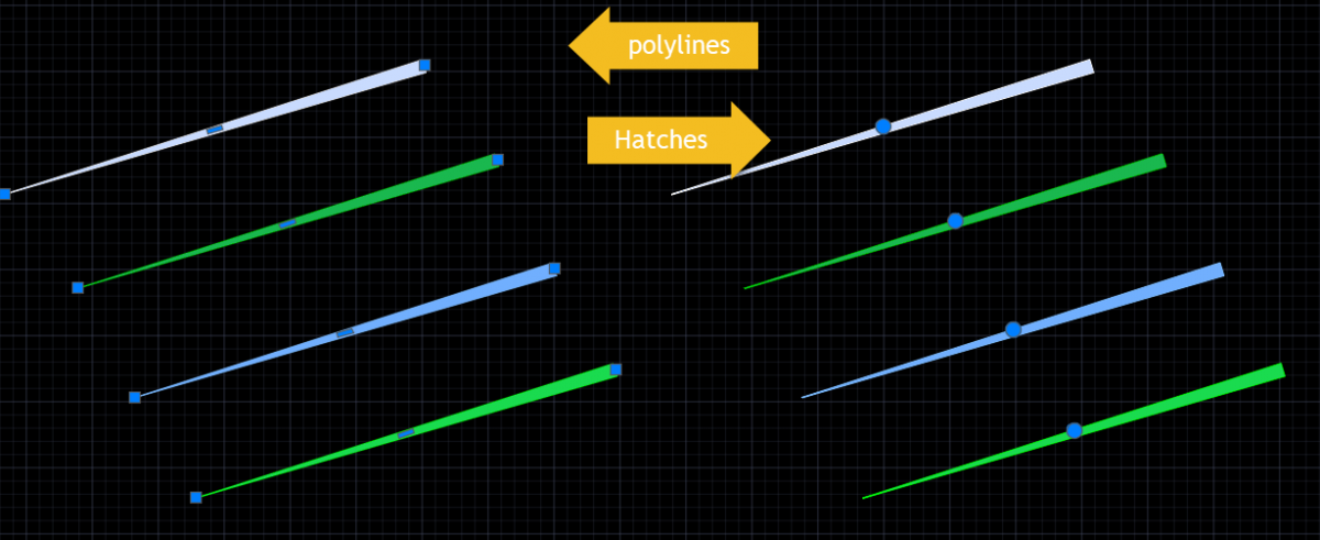

Lisp convert several polyline with width to hatch solid?
hELLO,
Is there a lisp that could change several Polyline with random thickness to Hatch pattrene Solid, with a lisp, when u type command P2H
see attachment.
test2.dwg
Hello Ronjonp, the lisp is almost perfect, but can u make it, so by command P2H, it autom. select all Polyline and make the hatch solid? like attachment?

Hello Ronjonp,
I load the lisp and type mpolyoutlineh, then the lisp still ask me to select te object etc? but doesn't automatic convert the Pline to Hatch solid?
it would be great, if the lisp not asking all the questions.

sorry confuse You, but my idea is, when i type mpolyoutlineh the lisp Lee or the yours it turns all Polylines to outline and instant change to Hatch solid. so i dont have to select the polylines. Just 1 lisp do all the work, with one command like mpolyoutlineh

SOrry thx for yur time!😉 The lisp works good, but there are severals steps 2 do it, Like when i type MPOLYOUTLINEH, it ask me select object, i then select objects, then it ask me delete yes or no, and i click Yes, then it finish.
I would like to see the lisp that don't have do step bij step, but instant change it. I do apolgize for all my mistaken/request.

Try this:

I think this is perfect 😀👍 ,with one command, job is done, tomorrow i will test it more, but i looks like it runs perfect sofar!!
I think the lisp works fine thanks alot!!!!  Ronjonp
