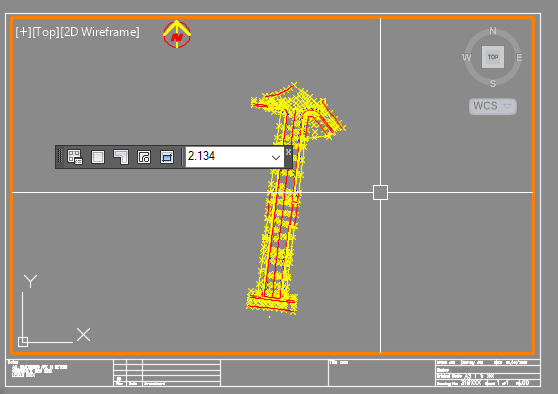

Basically I need to work in meters, and print to A3 and I would probably like to specify text and dimension lines etc in mm. I think I have the scales working correctly between paper and model space and the annotation but the text size for say 2.5mm I have it as 0.0025m which it rounds to 0.003.

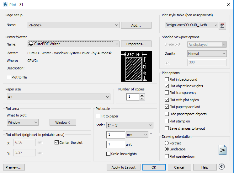

We work in metres so make sure your UNITS are set correct, to metres we just work at 1:1 in model a 2.5mm text would be 0.625 at 1:250 ie 2.5/4, we have our title block as an A1 but normally plot it from layout as A3 so set viewport scales correct then plot sheet at 1:2 for A3. If your text is 0.0025 something is not right.
Ok found it straight away make your title block in the layout as true mm ie 420x297 etc not 0.42 then set your Mview scale to suit and plot at 1:1. Our A1 is like 802x570 units. Your units are decimal thats ok but Feet set to metres ? I scaled title 1000. start from there. I changed all your layer line thickness to 0.0 I just found using a ctb easier for line thickness so we plot by colour. We use plines for extra thick lines only.

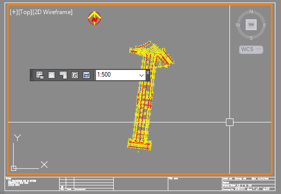

Because your metric turn on the viewport toolbar when you go into the model view a number will appear you can type over this number and it will reset the scale look at image. I did a zoom extents it was 2.134 in the view port i overwrote it to 2.0 it then became 1:500 for an A3 sheet. It is a road in metres. scale is 1000/500 =2 1000/250 = 4 lastly we set our lower left title block to 0,0 and have some offset no plot corner markers, but we use auto plot routines so corner is relevant.
