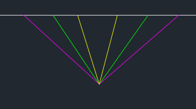

The real problem is that I need to recreate the ditch system they has an angle of 65-80 degrees.
A single profile is the equivalent of cutting a ditch  perpendicular to its centerline and looking at it head on.  You can create a profile with any angle you want.

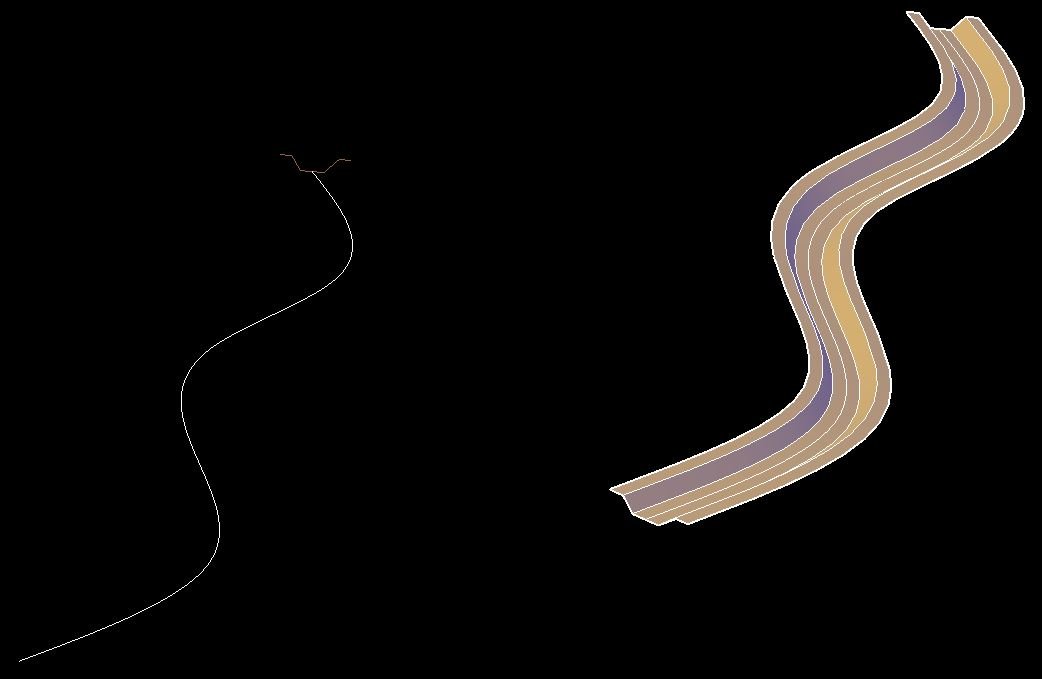

Here is an example of a simple approach.  Create the profile of your riverbank (use a single continuous polyline) and extrude it all a spline representing the center of the river.  Look at the image below.  On the left side we have a spline (white) and a simple riverbank profile (tan).  We extrude the profile along the "path" of the spline to achieve the result on the right which in this case ends up being a surface.
This is a day to day task for CIV3D or any other road design software. Remark has given you a very good answer. I would extend the banks above the existing surface which must be a solid make it a closed shape rather than flat edges then subtract from the surface this should give you a ditch.
Suggestion 1 There are some free civil design software out there just google it is found here at Cadtutor.
Suggestion 2 Ask here nicely its a few minute job to do this if you supply a dwg with 3d faces. A water surface can be added pretty easy also as a seperate surace for rendering.
