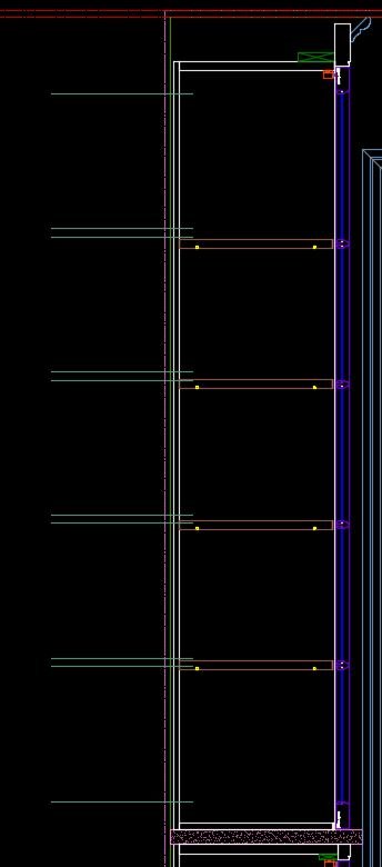

JoeyG_77 Posted February 27, 2019 Share Posted February 27, 2019 Hey everyone ... Im trying to make a macro that will when I pick 2 points that it will draw that line .074 short of the 2 points in the Y axis. Im having trouble with the code for it. This is all I have so far and it wont go any further after I get to the from. ^C^C_LINE;\FROM;\@.074<-90;; Thanks Joey G Quote Link to comment Share on other sites More sharing options...

JoeyG_77 Posted March 6, 2019 Author Share Posted March 6, 2019 Hey BIGAL ... Thanks again for all the help w/ many lisps and advice given over the years. You asked a question and I didnt know how to answer about the offset value. I have something along the same line but alittle more involved i think. I work for a cabinet shop and making changes all the time. I would need a lisp that would be able to pick 2 points then ask what my subtraction would be and then minus that from the overall dimension that you picked in the beginning. Then you would have to divide that into equal spaces based on a number you entered. Then it would draw 6" lines @ every point . Quote Link to comment Share on other sites More sharing options...
BIGAL Posted March 8, 2019 Share Posted March 8, 2019 So you draw a rectang and dimension it but the dim has to have a undersize tolerance so you can push it in, correct ? That is easy use dimension overide and change dim value. I am not sure about the offset lines post a couple of examples. When doing a BIM of the sheets check for textoverride value and use that. ; IAcadDimRotated: AutoCAD Rotated Dimension Interface ; Property values: ; Measurement (RO) = 44.09 ; TextOverride = "" ; change dimension value by an amount ; By Alan H March 2019 (defun c:foo ( / ans dist obj) (setq obj (vlax-ename->vla-object (car (entsel "\nPick Dimension")))) (setq dist (getreal "enter distance")) (setq ans (vla-get-measurement obj)) (setq ans (- ans dist)) (vla-put-TextOverride obj (rtos ans 2 2)) ) (c:foo) Quote Link to comment Share on other sites More sharing options...
