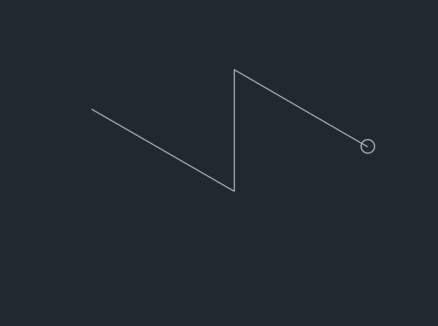

I am using AutoCAD 2018 with 3D,  how would you guys draw this pipe run in 3d? I have very less experience with 3D, can i started as shown on the right by draw pipe run and circle then extrude or sweep?  any suggestion. thank you

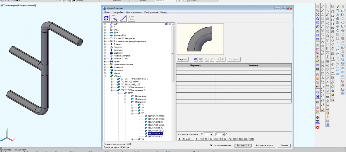

We do this (dwg file attached):

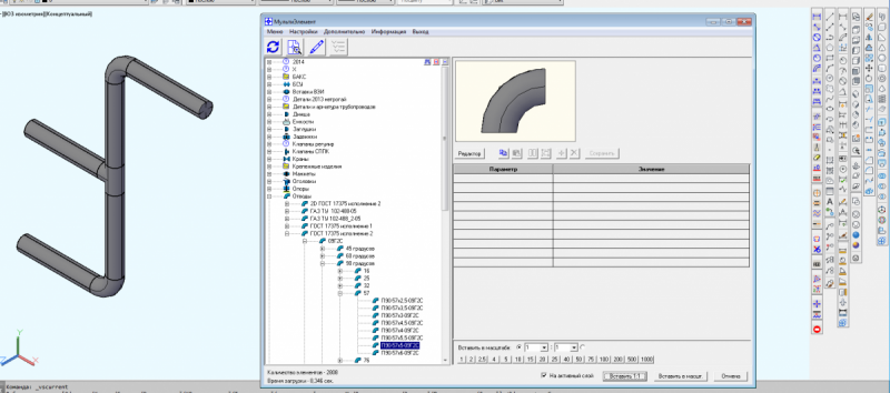

maratovich
Yes, the usual AutoCAD 3D. Without additions.
Why didn't you see the sample file?
We use 3D objects and blocks.
We use the program to store blocks, it allows you to visually display and insert a block from a folder. (on the picture)

as far as the method to draw, do i need to draw a line and circle perpendicular to it and extrude to show 3D? i am just don't know how to start, i started from scratch, do i need to have all the fitting drawing individually in 3d and bring in?

Thought as I dont do pipes normally using 1st principles of solids but very slow, the way to go is like Maratovich and Remark.

I draw individual center lines (each pipe and elbow) then sweep a circle (or region) of the pipes.

Hi to all, I don't know if this thread was finished, but just one suggest, It's possible to draw a 3D Polyline (3DPOLY) and extrude it after (option path), I normally use this way, similar to the Bigal's post.

If you want to keep this in plain AutoCAD, do a little prepwork first. Create each pipe OD and ID and extrude it 1" to make a pup piece. Then, use a catalog like Weldbend to create your 90s and 45s, etc. Make blocks of each one, throw them on a Tool Palette.
Utilize Dynamic UCS where you can. Place these items, and use the Grips to stretch the pipe solids, and connect the elbows as necessary. If you're going to this length though I would consider a piping package such as AutoCAD MEP.
