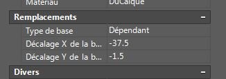

Adju Posted March 14, 2019 Share Posted March 14, 2019 When i talked about the offset of the scale function, it was not about to be drawn offset. It was more that you manually put on offset in the parameter. This is a capture of the property table when i select your scale function. Quote Link to comment Share on other sites More sharing options...
