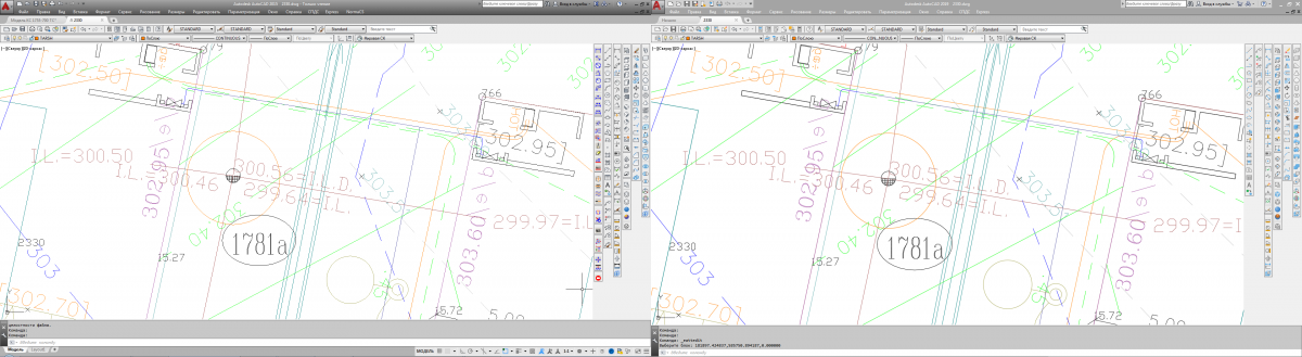

samifox Posted April 2, 2019 Share Posted April 2, 2019 my co-worker running acad 2019 sent me dwg, in his screen he can see the attribute value, but in my screen, i can see the attributed block but the values are blank. we use the same fonts how that possible? Thanks S2330 - Standard.zip Quote Link to comment Share on other sites More sharing options...
maratovich Posted April 3, 2019 Share Posted April 3, 2019 where is? in which block? Quote Link to comment Share on other sites More sharing options...
samifox Posted April 3, 2019 Author Share Posted April 3, 2019 (edited) in my pc il =xxxx is missing we are using the same fonts Edited April 3, 2019 by samifox Quote Link to comment Share on other sites More sharing options...

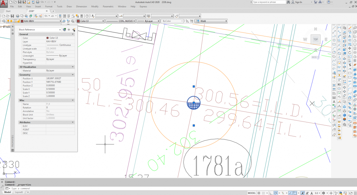

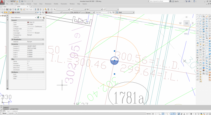

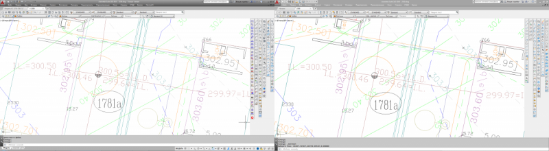

maratovich Posted April 3, 2019 Share Posted April 3, 2019 Look carefully at the picture. I gave you the AutoCAD 2019 and AutoCAD 2015 In both there are no attributes. Quote Link to comment Share on other sites More sharing options...
maratovich Posted April 3, 2019 Share Posted April 3, 2019 AutoCAD 2020 - no attribute. April 1, your colleague joked you. Quote Link to comment Share on other sites More sharing options...
